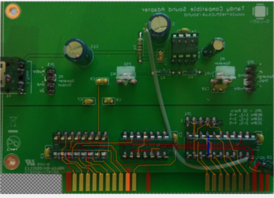

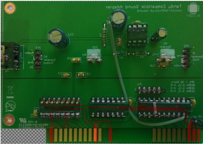

Reply 103 of 114, by matze79
had few minutes time to draw backside..
maybe i have later time to reconstruct front and make some schematic files.
    151.22 KiB
    1649 views
Reply 104 of 114, by matze79
pretty much done.. drawing now a eagle schematic.
1.08 MiB
1607 views
with limited time this is pretty annoying..
i don't want wait longer.
