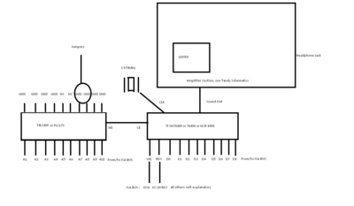

Reply 22 of 114, by Great Hierophant
My idea in a nutshell :
22.01 KiB
2076 views
I know its a crappy Paint rendition, but it is the best I can do.
Reply 23 of 114, by carlostex
No worries, we know that it should be a relatively simple circuit. All we need is to find someone who can engineer and put it to the test. I'm going to try and contact Bryce at AmiBay. Then i should see if someone is interested at VCF.
