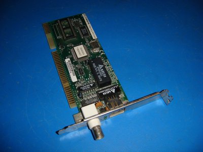

I've just recently bought a non-PNP ISA Linksys Ether16 LAN Card. I've installed it into the system and it seems to be working fine. Lights are blinking, though on my router's end, I'm getting an orange light (Using a NETGEAR Router if that's relevant info). So anyways, I've installed drivers in Windows 95 and I could NOT for the life of me get the LAN card to even function properly. I've tried the stock drivers that came with Windows 95 and the drivers from online and different configurations. No changes. Any suggestions?

Is this the card?

@Caluser2000 Yes, that's the exact card that I'm using.
