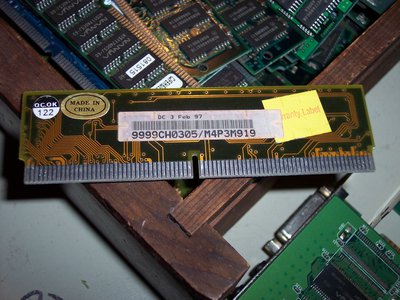

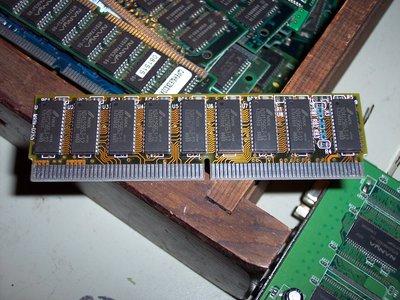

Reply 53 of 54, by stuvize
Wasn't sure were to post this but I have a 12ns cache module for the M919. At first the only difference seems to be the 12ns chips but this module is watermarked "M919-02S5" and all the 15ns modules seem to al be watermarked "M919-01S3" the circuitry is also different on these modules. I purchased this module in a lot of memory and cpus from Costa Rica labeled as scrap.

Reply 54 of 54, by feipoa
I have three M919 cache modules, all are 15 ns. Does seem odd that PCChips would use more expensive 12 ns SRAM on your module. Aside from the fact that perhaps PCChips just had these modules laying around, or got a hot deal on them, I wonder if there is any other reason they would have used 12 ns SRAM.
