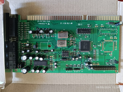

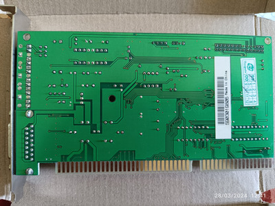

I just got a YMF719 which seems to have the 5th pin and I am not sure if it requires -5V for proper operation. Please see the images below. Could someone please let me know if this requires -5V? If so I may have to return this card as I don't have an AT PSU.

stealthjoe wrote on 2024-03-28, 07:12:
No, that card does not require -5V. The pad is there, yes, but there are no traces coming out of it.
Thanks a ton for confirming! Feeling at ease now 😊
