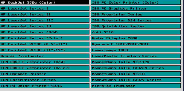

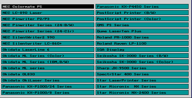

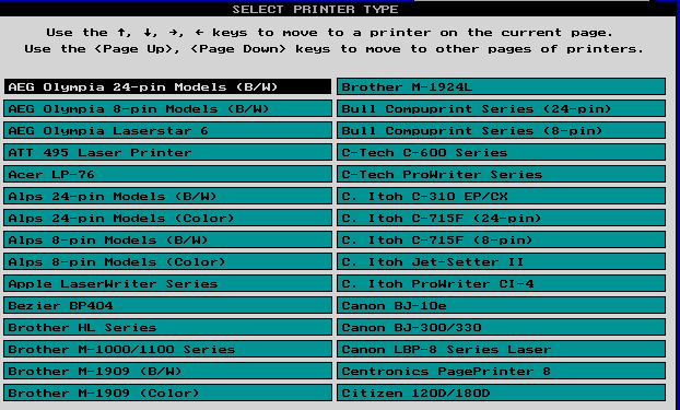

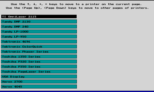

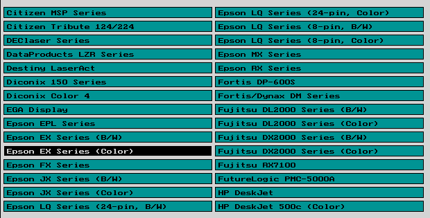

First of all, thank you fizzban for the excellent patch for printing. I was struggling with win98se to print some files of a old dos medical program.
I managed to print the graphs and text but so far I can only get to print in black and white. The program I have is a pain in the #$ because it comes with the printer drivers integrated and some printers drivers work and some dont with the patch. Without Dosbox it was crazy to find a modern printer compatible with dos and win98 The emulation works perfectly for the 24-pin printers listed in the program THANK YOU!!!
When can we expect the color version patch debut.?
Here I send pictures of old printer names in the program so that we can all remember those beautiful times of the screeching symphony and the old printer paper, those where the classic times! !this young boys today have it easy! 😁
