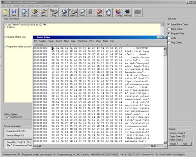

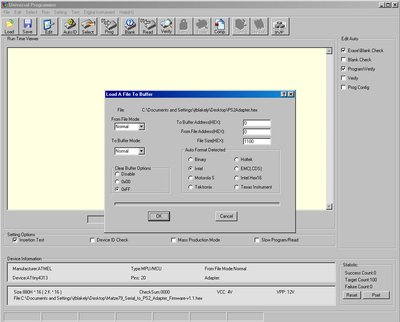

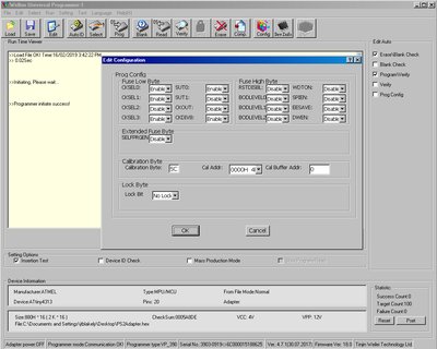

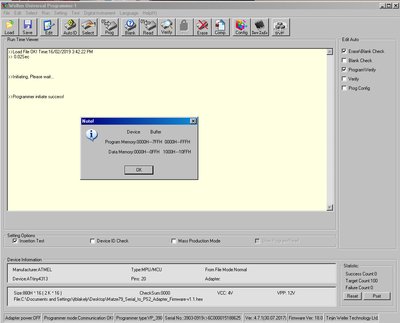

Here are some of the configuration settings I see when using the Wellon VP-390 to program the ATTiny 4313-PU. Perhaps changes are needed to get this working?
EDIT: Looks like Vogons split up the pages. This current post and my previous post on page 15 go together.

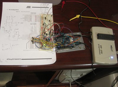

EDIT2: I managed to reset the efuses using this schematic on a breadboard and an Arduino. Thanks to Madowax for this suggestion. http://mightyohm.com/files/hvrescue21/HVRescu … 1_schematic.png

After several days of struggle and conversation with Madowax, I was able to get the Atmel ATtiny 4313's firmware flashed to version 1.1. A diary of notes follows.
I needed to reset the fuse bits because on my first attempt to update the firmware with my Wellon programmer, I did not set the config page correctly.
I followed the instructions for the simple AVR programmer using the parallel port. I used the software provided, FWT1201I3TH9DY2.rar. To simplify my life, I used Win9x so that the software has direct access to the hardware and I didn't need to use some I/O driver for NT-based operating systems. Unfortunately, was unable to get it working properly. Although the Hardware Check appears to check out OK, I received a verify error upon writing the firmware (Writing HEX, verify failed at Adr: 0001, File 0F, Read 02). Also, when I attempted use the serial programming interface (SPI) to read/write the fusebits, I would well it to write low fuse bits with command AC A0 -- FD, but it would return AC A0 A0 00. Also, If I used the SPI command to read the low fuse bits (80 00 -- --), it would return 00. I connected to the ATtiny while in the PS/2 adapter.
I tried this guy's AVR rescue, but it wasn't working properly. https://www.robotshop.com/community/forum/t/b … cue-shield/2898
I was, however, able to get this guy's AVR rescue working, https://mightyohm.com/blog/products/hv-rescue-shield-2-x/ . It seemed rather finiky though. Sometimes it would do a 1+ increment on the readback of the fuse bits set. It also didn't like you to write the bits more than once on a single power cycle of the Arduino. Note that I didn't use a 5V to 12V boost converter as shown in the schematic ( http://mightyohm.com/files/hvrescue21/HVRescu … 1_schematic.png ), nor did I have a MUN5311DW1T1G to use as the 12V switch, so I used a PNP, NPN, and four 10K resistors (which is what is inside the MUN chip). I also added 100 ohm resistors to the ATtiny's pins.
What finally worked?
1) Use the Wellon VP-390 to write the new firmware using settings such that all are Disabled except for CKSEL1, SPIEN, and SELFPRGEN. Note that I had the external 8 MHz crystal wired to the ATtiny4313 while it was inserted into the Wellon socket. I put the ATTiny back into the PS/2-to-serial adapter, but the DOS driver wouldn't find the mouse.
2) I put the ATtiny into the breadboard and used the AVR rescue technique with an Arduino EtherTen. I used Arduino IDE 0022 with the supplied code and the serial monitor in attempt to program just the fuse bits. Note that I has the 8 MHz crystal wired to the ATtiny with jumpers cables. For some reason, the USB cable must be attached to the Arduino before the 12V cable. I told the interactive mode of the software that I wanted to use for the low bit, high bit, and extended bit: 0xFD, 0xDF, and 0xFE respectively. After burning in the bits, the serial monitor reads back the programmed values of 0xFD, 0xDF, and 0xFF. To my surprised, it did not do the 1+ increment on the low or high bits, but on the extended bit. So what value is the Ebit really at - FE or FF? I'm not sure. If the read back is correct, then SELFPRGEN (SPM instruction) is disabled. Is this needed? I didn't want to mess around with more programming using the AVR rescue technique because I didn't want to bugger up what I had.
3) I put the ATtiny back into the PS/2-to-serial adapter and turned on my 486 with it connected. To my shock, the DOS mouse driver found the mouse! I had done this step 2 dozen times after trying to upgrade the firmware and it didn't find anything. So I ran the Test.exe program to test the mouse speed. It was horrible, in fact, far worse than the original firmware.

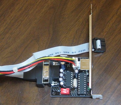

Attached is a photo of the breadboard mess.

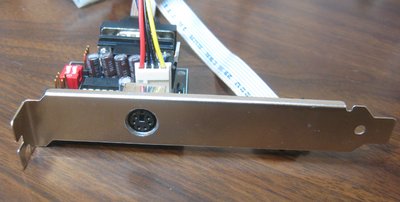

Here is what I did with my PS/2 adapter to get it mounted onto a slot bracket. Found some flat slot covers on eBay, the tinner the better, but with a 90 degree reinforcement bend. If your slot cover is too thick, the ps/2 mouse pins might not make contact with the female DIN. I then JB Welded it (epoxy) to the bracket along the whole edge of the PCB and around the metal din housing. Be sure to scratch up the shiny stainless steel contact surfaces so that the epoxy can adhere firmly. Use wood joiner clamps to secure the bracket to the PCB while JB Weld is drying. Solder on a pin header for the 12 V power connector. Find some longer bolts of appropriate threading to screw in the serial cable. Upgrade to firmware v1.1.
I was previously using a Logitech Bus mouse on my NexGen build, but I'm hoping to swap this little guy in the case and ditch the bus mouse. Before doing so, I want to run Quake timedemo with the mouse enabled and compare it with the results from using the ps/2-to-serial adapter at 19200 baud.

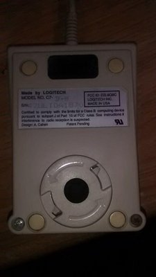

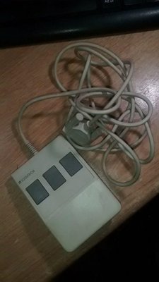

Logitech C7 has arrived.
So we can now investigate 9k6 Baudmode
Reply 317 of 381, by matze79
Does not work on Windows 95 😒 indeed supports 9600 Bauds in Mouse Systems Mode.
But i did not get it working yet.
So we need to hack a 9x driver.
But 9600 Baud mode works on ReactOS 😉
