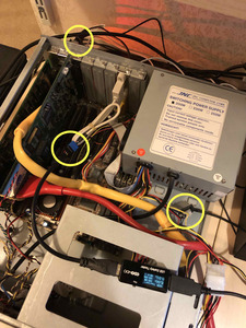

Reply 362 of 381, by SmooBandit
SmooBandit wrote on 2020-11-25, 18:59:
I'll have to get some kind of Frankenstein Molex -> USB A -> USB MiniB converter, and then I'll be able to power it off the PSU, but in the interim, a battery bank is going to do nicely given the very low power draw.
I have now managed to get the Frankenstein's monster power supply for the Adapter up and running in my 486 chassis. I went:
MOLEX from 200W AT power supply
to:
30cm Molex to USB A Female
to:
9-Pin USB IDC Dupont Male Header To Single USB-2.0 Type A Male Cable Replacement
to:
Dual USB 2.0 plus Game port motherboard expansion rear panel case bracket
to:
Generic USB type A to USB MiniB cable
to:
the Adapter.
It works great. My 486 now has built in USB power for the adapter and my USB speakers. The only bit that is external is from the rear USB panel to the adapter, which is fine with a 15cm cable. Internally, it's a birds nest of hideousness that I need to manager better. As a neat bonus, I get to connect the game port to the VLB IO card's game port header for non-soundcard joystick goodness.
Total cost is something like £15 delivered for all the bits and bobs for the power supply.
Pic attached of all the cable based madness with the connections highlighted for clarity. Bonus USB tester included showing a nice 5v power draw. (not shown is game port hooked to IO yet).
    550.77 KiB
    2168 views

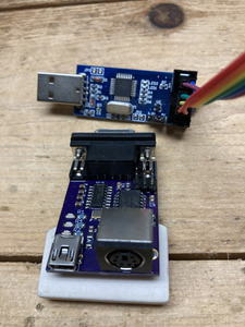

Reply 370 of 381, by leonk
I assembled the device and programmed it using avrdude (avrdude ran in Windows 7, under VirtualBox on a Mac; yes it can be done!)
I think the only difficulty someone new to this project will find is the lack of PCB silkscreen of all the components. I had to load the schematics into an online viewer and verify the traces to figure out what pad is what.
I tested a real PS2 ball mouse and usb to PS2 laser mouse. Works amazing in Windows 3.1 running on my 486!
1.49 MiB
1915 views
1.11 MiB
1915 views

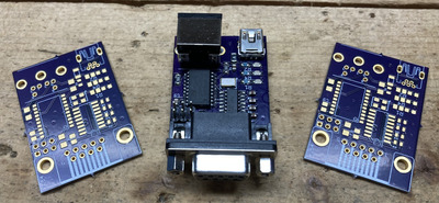

Reply 379 of 381, by matze79
You can order from Serdashop.com
