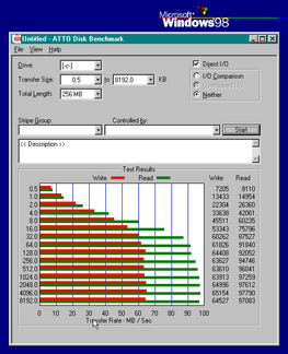

Thanks for the suggestions. I haven't changed the PIO/DMA modes yet, but I did try different PCI slots.
ATTO now says 70MB/s (!) on sequential transfers. If this is accurate I'm very pleased. Especially once I put in an SSD for the quick access times.
70 Meg a second is 3x my expectation and honestly I don't think it's accurate but I don't have a way to test max drive bandwidth apart from with synthetic benchmarks (unless I figure out/set up a RAM disk in W98)
Anyone think this is a reporting error? Or realistic? 440BX, P3 1G, 160g 2.5" Seagate momentus.

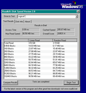

Thank you for these instructions. The BIOS update worked perfectly and my controller is now IDE-only. The Delock drivers that worked for me in Win98 however were the RAID version, after which everything is perfect and the controller program now shows up in Control Panel. This is the generic card I used.
I'm attaching the files, and uploaded them as well: https://archive.org/details/sata-sil3114-windows98
