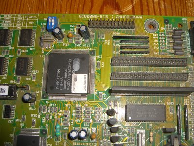

Reply 45 of 4609, by Skyscraper

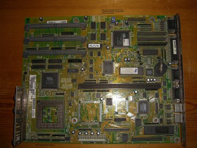

I guess most of you have read my rant about the Italian seller who sold me some "used" hardware which in reality was some stuff he found in a dumpster or at the road side. The stuff has clearly been laying outside it the rain for an extended period of time. As these parts are sort of dumpster finds, just not found by me I will post pictures here and tell what is working and what is not. 😀
First out is what I think is a motherboard from an old IBM 486.
The not pictured CPUs I got in this lot, an Intel SX33 and an Intel SX2-50 both came with bent pins.
Here is the motherboard, it was jumpered for 33MHz so I installed the SX33.
2.8 MiB
3508 views
Close up showing the lump of solder by the crystal near the video (I have moved the switches to on).
4.33 MiB
3508 views
Some rust.
4.22 MiB
3508 views

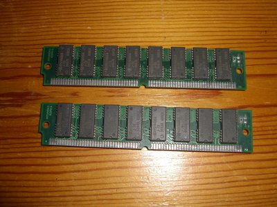

What I think is the memory belonging to this board (Im not sure as they were removed from the board when I got it).
4.26 MiB
3508 views
So what do you think, does the board work or not?

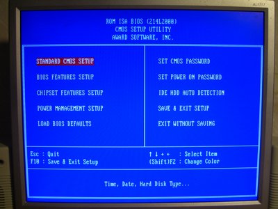

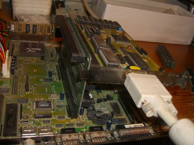

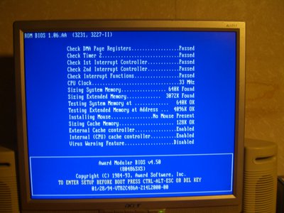

Reply 48 of 4609, by Skyscraper
oerk wrote:
LPX form factor. Certainly looks like IBM, but could very well be another manufacturer entirely.
In that state? I'd be afraid to try it.
I already did! 😀
The board posted at the first try.
The onboard video is dead, I guess thats why it was disabled, it could also be there is too much corrosion in the VGA connector. I could still see that the board posted as the Num Lock key worked so I installed the riser which I luckily also got in the lot and installed a Tseng ET4000, only cowards use cheap VGA cards when testing potential fire hazards. 😁
I did not try the very corroded memory modules.
The ISA riser with an ET4000
4.3 MiB
3481 views
The Post Screen
4.01 MiB
3481 views
The Award BIOS
3.82 MiB
3481 views

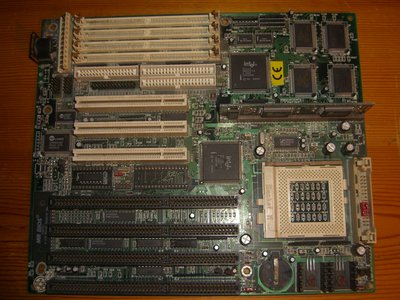

The next board I tried was this PC Chips Intel 430VX chipset motherboard. I do not think the BIOS chip belongs to this board but it was there when I got it and any BIOS for Intel 430xx should at least be enough to get some beeps. The board seems totally dead, I tried two differnt pairs of FPM memory, the Pentium 75 I got with the board and also a known to be good Pentium 133. I rejumperd the FSB to 50MHz as the board came jumpered for overclocking the P75 to 100MHz but that diddnt improve the situation.
PC Chips Intel 430VX motherboard.
4.34 MiB
3448 views

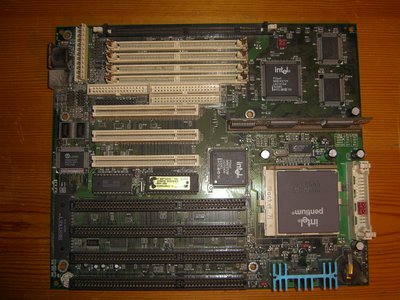

Then I tried the PC Chips 430FX motherboard that came without BIOS and RTC chips. I think this is the board the BIOS chip that came mounted on the 430VX board actually belongs to so I moved the BIOS chip and RTC chip to this board but it seems just as dead as the VX board.
PC Chips Intel 430FX motherboard.
4.32 MiB
3448 views
There are no obvious defects on either PC Chips board except rust, dirt and dog hairs. I guess the BIOS chip could be dead, its not like these boards are worth spending too much effort on. At least not now perhaps some rainy day far into the future when a PC Chips 430FX motherboard with what looks like two real and two fake cache chips adding up to 256KB onboard cache with another 256KB cache added on a coast module is worth a fortune. The VX board seems to have no fake cache chips and two real ones like the FX board with 256KB more added on a coast module, all in all a less interesting board.
Or perhaps all onboard cache is fake but if that is the case they have wasted alot of effort on worthless traces 😜.

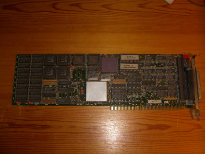

Member CelGen thought this mystery card with a socketed 80186 CPU was a multiport serial card, I think he was right as the Zilog chips seem to be "ZILOG - Z0803008VSC - Serial Communications Controller PLCC"
4.21 MiB
3443 views
If wasnt for the shipping cost this would not have been such a bad deal but I do not like when some sellers sell untested junk they have found as "used" supposedly working items. I will not ask for a refund or give the seller bad rep but I will not buy anything else from this seller.
Reply 51 of 4609, by alexanrs
That board looks like a PCChips M520, one of the few PCChips boards regarded as being actually good. You can easily find the BIOS on the internet, so you could easily test it if you have a programmer.
Reply 52 of 4609, by Jr_

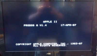

Reply 59 of 4609, by torindkflt

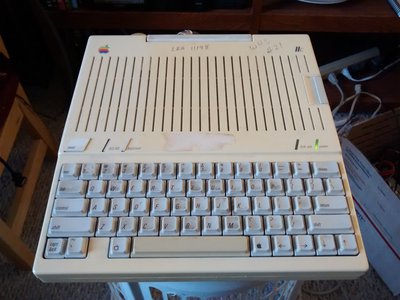

The only genuine trash find currently in my collection is this Apple IIc, but I didn't find it "recently". I actually found it in a pile of stuff to be thrown away when I was in high school 15 years ago. It was one of the last remaining Apple II systems in the school at the time!
1.38 MiB
3230 views
283.22 KiB
3230 views
I had to replace the disk drive and I might sometime soon need to replace the keyboard, but otherwise it works quite well. It badly needs a thorough cleaning, which I probably should have done when I had it apart to replace the disk drive, alas I was suffering from a bout of lazyitis at the time. :p
Doing trash picking here is kinda difficult to do. The city I live in has one of those stupid "once you throw it away it becomes city property" clauses, it is literally illegal to pick up stuff put out at the curb for disposal.
