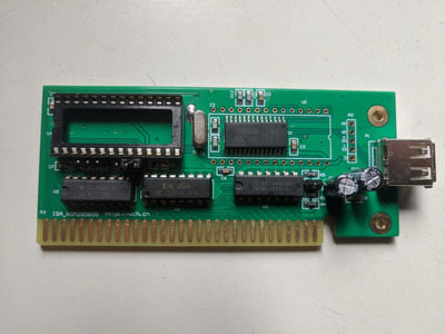

I had assumed it was a clone of https://www.lo-tech.co.uk/wiki/Lo-tech_ISA_USB_Adapter That has 4 jumpers.
Mine has 3 jumpers.
J2 & J3 combine for 6 pins and 4 labeled positions: 23x,24x,25x,26x It arrived set to 25x. Would this be IO port address, yes?
J1 connects to pin A10 (I/O CH RDY ??? ) on one side and I think ground on the other. It arrived unjumped.

The top is buggy (ROM chip select not properly done).
The bottom looks like the DIL (dual in line) version of the top.
The middle one uses a GAL, a programmable chip, but I wonder if it has enough I/Os to do the decoding of the IO address and the ROM address?

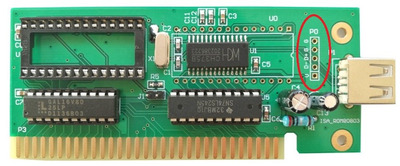

Sounds like you are saying that all three versions are affected by the rom issue. Is it something that can be patched?
Also, has anyone tried putting a header here and making a front panel usb port?
92.38 KiB
1211 views
Reply 156 of 167, by Sphere478
Header should work. 😀 seems to tap lines in parallel. So if only using one, should work. Idk if USB would like two in parallel

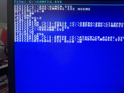

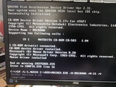

Been on it 2 days. Hope someone can help.
My computer 486DX2 ISA VESA Local Bus
Purchased Industrial Control Card ISA to USB Computer Expansion Card on Ebay
1.18 MiB
1133 views
971.47 KiB
1133 views
1.71 MiB
1133 views
1.49 MiB
1133 views
Tried changing Config.sys to
DEVICE=C:\CH375DOS.SYS to match the others in the CONFIG.SYS Still no luck
I have tried changing speeds. I am sure am doing something fundamentally wrong.

Is the file present in C:\ ? Did you remember to copy it there.
the only thing you didn't show is a dirlisting of C:\
if it is actually there, verify the filesize and/or try another version you can find in this thread.
