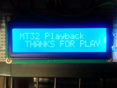

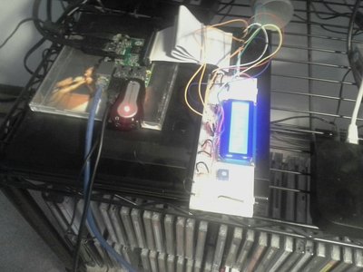

Got a working GPIO driven LCD for SYSEX messages.
Re: Emulating MT-32 on an RPi2
    388.2 KiB
    2759 views
    See you later, Detective Bonds!
    533.55 KiB
    2759 views
    Pi 2 and dual row LCD on my entertainment rack
