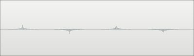

Reply 31 of 112, by superfury
I've changed the functions a bit, but I seem to get strange waveforms using a simple test signal:

I now get a waveform, which results in a bit of a strange 'sinus':
25.89 KiB
1311 views
The waveform that gets output (at ~49kHz), viewed in Wavepad Sound Editor.
Is this correct? Aren't the curves supposed to be round using the table? It's supposed to be a D#.

Edit: I seem to have fixed it by implementing the 0th entry as max instead of 255th entry(which is 0). This gives a proper waveform(sort of a sinus, although not perfectly round):

Reply 32 of 112, by superfury
The adlib emulation is now correctly generating sound again(this time using the two lookup tables (Exponential and Log-sin tables) instead of the old sin() functions).

The sound doesn't sound right, none of the instruments give correct output for some reason.
The song played is the Rhythm.dro file from DOSbox' OPL Emulation - Rhythm Sounds
recording_63.zip
