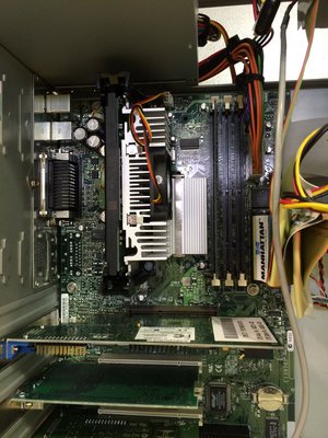

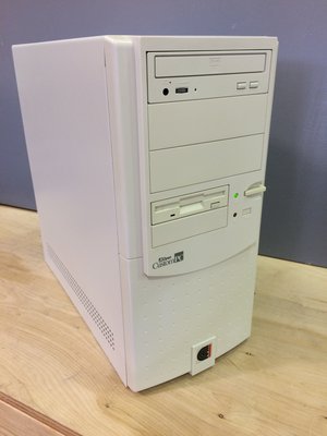

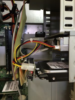

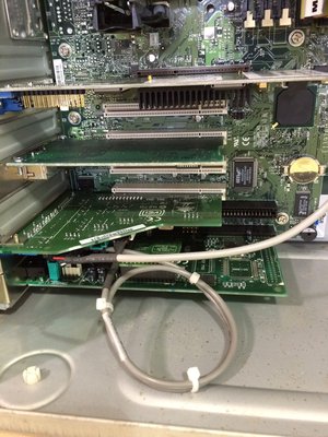

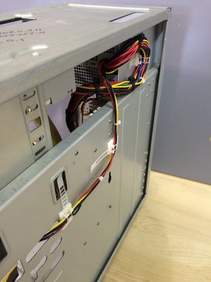

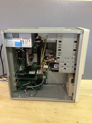

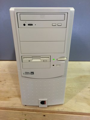

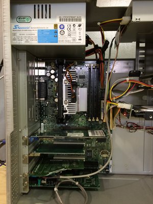

Ok, I'm not done but here are some pics. I need to make a shorter internal audio cable, make custom length IDE cables (probably just ATA-33 cables, I hate folding ATA-66 cables), I have to put in an IDE drive to replace the SATA drive. Sorry Phil, but this build just has to have an IDE drive... It works great but part of me just has to have the real thing. I need to do some more cleaning but might not hehe. She isn't perfect but she looks pretty good to me!
I want to do a more detailed write-up later but want to at least get a few pics out.

Reply 73 of 90, by PhilsComputerLab
Very nice!
We should swap audio cables. Mine is too short 😀
Before you swap out the drive, make sure you enable DMA mode in device manager (on the HDD), and run a ATTO benchmark. Then compare it to the IDE drive you will be using. I'm keen to see the difference.

Reply 75 of 90, by brostenen
What a great looking system you got together there.
Love it. Clean build and nice parts. Funny that term "custom build'.
Is that just a term which covers no-name/home made in general?
Reply 76 of 90, by squareguy
They were sold as kits from Aopen to local computer shops. I know they came with case, power supply, motherboard and I'm not sure about floppy and CPU. The shops would finish them with whatever they wanted for their customers and put their 1"x1" logo on the bottom. They were very good kits and shops would but them by the pallet full.

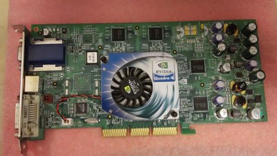

Well, I decided. I want late DOS support. Snagging a few Quadro4 700 XGL's now. Basically a very well constructed GeForce4 Ti 4200. I also stumbled on a P3 800 CPU that I may, or may not, use on this build.
Edit: Here is a pic
