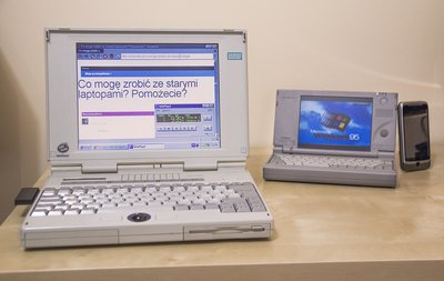

this browser is really fast: http://sourceforge.net/projects/dplus-browser/
i can enter even mobile version of Facebook with that and be able to chat. The downside is that of course not all scripts work.
On the photo you can see 90MHz notebook with wifi card installed, running that browser and internet radio.
You can use Orinoco wifi card (i used that in this laptop, it works also with MS-DOS and Win 3.1) with pcmcia to PCI adapter, but it only works with WEP encoding. I have Asus router, which can split the Wifi signal to 4 guest networks with different encoding, so I can have WPA2 encoding and enable additional WEP network when I need that.
I even used that in 486 (seeing 486 laptop with Win 3.1 and WiFi, running on battery is priceless :p)

You got a libretto 😳, that's a nice netbook, It's just bad that I'm full of old computers (a c64, apple II and a desktop)
