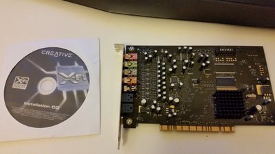

I worked for Dell/Alienware few years ago and I still have the card and CD.
246.36 KiB
5405 views
EDIT: Yes, the UAA (Intel HD Audio) was a requirement from Microsoft.
From Wiki:
"In Windows Vista, the Windows Logo program requirements state that any machine shipped with Vista must include a UAA-compliant audio device that works without additional drivers."
EDIT 2:
I think the card has only 16 MB X-RAM. But I am not sure.
Reply 10 of 11, by Swampy
Yes, it is 2MB. I remember 16 something..but it was Megabits 😀
Phil's card is missing the Dell part number and the layout is slightly different than mine. Notice the PCI connector and the front panel connector. It may have other internal differences.The Dell part number is WW202. His PCB is from week 36/2007 mine 44/2008.
