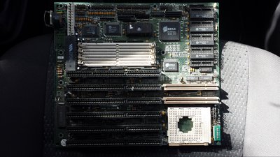

I got, next to free, a 486 motherboard made by Mitac (actualy Tyan), model IH4077D.
I thought it was a simple vlb board, but i never heard about the Efar EC802 chipset.
Does someone here had ever seen this board?

I'd be more worried about the exposed EPROM. If it still works, get an (E)EPROM programmer and back it up ASAP. Also, use some black tape and cover it up.
This chipset could be just a rebranded one. I have a DataExpert 486 with an ALi chipset rebranded as ExperColor.
Reply 2 of 11, by Sutekh94
That's what I was thinking. I got nothing upon trying to look up this chipset, so it's probably relabeled.

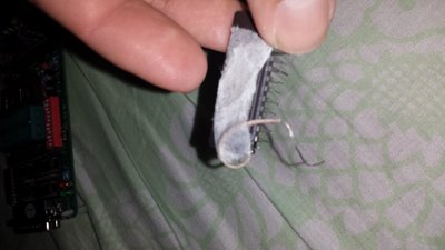

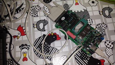

I was worried about the bios too, one broken leg and some others bended.
After some soldering, the bios was dumped and looks ok , but i'm not sure.
Im from Rio de Janeiro, and you?

I'd get a compatible EEPROM chip and program it just to be safe.
Also, my 486, despite the rebranded chipset, displays "ALI" as part of the BIOS ID string that shows up during POST. Perhaps you could identify your like that.

I dont think its a just relabeled chipset now:
- Another motherboard uses the same chipset: DFI G486-EVB http://www.elhvb.com/mobokive/Archive/Dfi/man … evb/486evbc.pdf
- This chipset has his own bios string http://www.kva.kursk.ru/bios1/numbers.shtml
- Efar was a true chip manufaturer bought by smsc in 1996.
Would be great resurrect this board and benchmark this strange chipset.
