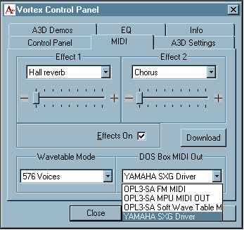

Can you pls post a screenshot of the Vortex 2 midi selection box with the added options?
Strange that the stock Microsoft GS Synth is not there.

Reply 27 of 31, by squareguy
Hey Gerwin!
I will post a screenshot tomorrow for you.
Yeah the MS Synth doesn't show up.
I believe you need WDM sound card drivers for the MS GS Synth to appear as an option, and I don't think there are any Win98SE WDM drivers for Aureal Vortex 2 cards.
