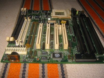

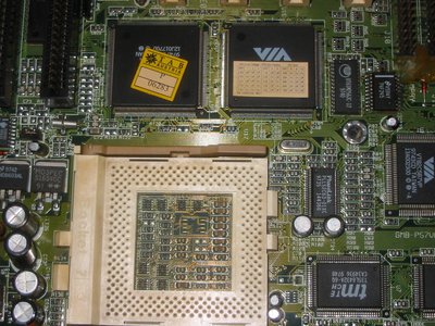

Hi all,
a few weeks ago I bought a Gemlight socket 7 motheboard from ebay,convieniently it has the settings on a couple of stickers on the chips, problem is however that i can not get it to work with anything other then a Intel 233MMX witch is how the board was set when it was sent to me. at the same time I also bought a Cyrix 6x86 166+ & a Winchip 200mhz. Other problems I have are the custom Silverball arcade machine bios the board has, this alows no changes whatsoever, except to load BIOS defaults, thats it. because of this I can't enable the onboard floppy controller. I don't really know the correct model number for the board either,so finding a manual is a problem. The seller identified it tentatively as a GMB-P57VPS, but this is not right, at least according to this:http://museum.ttrk.ee/th99/m/E-H/35588.htm
Should the 6x86 & Winchip run on this thing? I am pretty sure I got the switch settings correct for both, using the info on stickers but all i get is a black screen. it works quite well with the 233mmx, although i am getting random freezeing at odd times( I suspect a tired PSU). anyhow I would much appreciate any help with this machine, I am a bit out of my comfort zone with socket 7 and would really like to get to try my Cyrix and winchip out for myself.

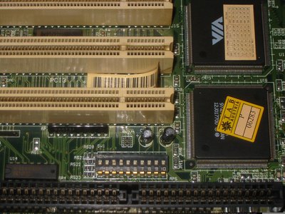

Thanks, my main problem is that the manuals don't match the sticker on the board or the layout of stuff, the sticker does not have all the data for the dip switches, for example sw4 & 7 arent documented on the sticker. Sw5 isn't in the manuals at all that i can see. It's all a bit of a trial! 🤣
Reply 5 of 8, by meljor
i would go with the stickers, as they came with the board. Not documented switches are probably reserved or do nothing so just leave them to ''off''.
Should be easy to setup the board:
3,5x 66mhz gives you the intel 233mmx, with 2.8v (setting at 1,5x is with intel the same and still works as 3,5x with this chip)
3x66mhz gives you the winchip 200mhz, probably 3.5v but there are versions that use 2.9v so do check
2x66mhz gives you the 133mhz cyrix 166+, this one has also 2 versions, 2.9v and 3.5v so check on the cpu
also run the board with one type of ram, so either sdram or edo but not both.
old cpu's can be broken so if both chips don''t work....
EDIT: looked at the manuals you posted and both do not have the sw1 switches like your board has it (you have it in a single place). in the manual all SW's are spread over the board so these are not the right manuals. You have a different board. Can't find the right manual either.

Thanks for the replies, so I have tried the Cyrix and winchip again using the setting on the stickers:
Cyrix 166+ switch settings Sw1 on, sw2 on, sw3 on sw4 off, sw5 off,sw6 off, sw7 off, sw8 off, sw9 off, sw10 off.
winchip switch settings sw1 on, sw2 on, sw3 on, sw4off, sw5 off,sw6 on, sw7 off, sw8 off, sw9 off, sw10 off.
Neither work, nothing on screen at all. also tried with those two undocumented switches 4,7 in the on position, no change.

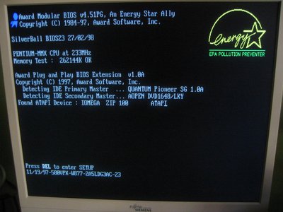

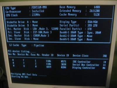

The seller had tested the board with a intel 233mmx, the above screen shot is his picture from the ebay auction, the switch settings he used were sw 3,4 on, all others off,so running the 233mmx at 3.2 volt(according to the stickers), and with the undocumented sw4 on, these are also the only settings for me also that are even fairly stable, if i drop the voltage down to 2.8v then i get emm386 errors and all sorts of instability. It runs well enough to have used phils utimate VGA benchmarks to test some PCI cards with sw3,4 on, but if you run it for long in crashes out. I have tried 2 different known good 32mb dimms(66mhz), I'm not mixing ram or using more than 32mb. only a single hard disk and CD rom are installed along with a clean install of DOS 6.22.
I wonder if the custom BIOS for the silverball arcade machine might be the root of the cause. As i said, it has no options when entering the BIOS apart from load defaults, or not, that it. So I am wondering if CPU support may have been removed from the bios apart from Intel? Even so I would expect the board to do at least something with the other chips even if it did not correctly identify them of run them correctly.
