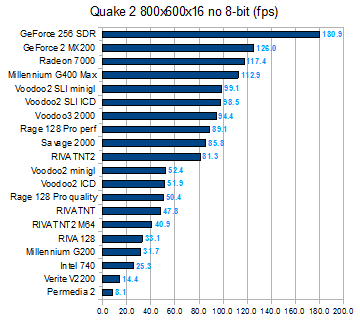

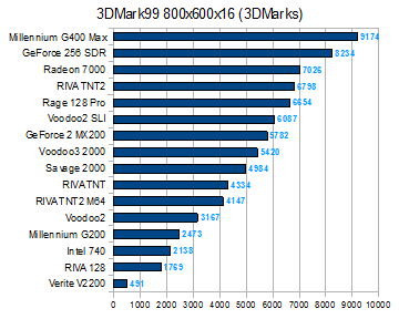

Here's what I saw when I tested cards on a P3 1400 a few years ago. G400 is looking a bit suspicious in its performance.
4.92 KiB
1110 views
And Quake2
5.69 KiB
1110 views

Suspicious in what way?
3dmark99 uses DX6, so GeForce can't flex its T&L-muscle yet.
In OpenGL, T&L does get used. Aside from that, Matrox never had very good OpenGL drivers, while nVidia has been the benchmark.

GeForce 256 SDR has a memory bandwidth deficit but almost double the fillrate of G400 Max. I don't see how a G400 can ever win dramatically against a GeForce 256.
Perhaps I will explore this again. I don't have a GF256 SDR anymore though - just the DDR version.

Yea, I'd like to see the feature tests for these cards in 3DMark99.

I figured it out. Vsync. The Geforce 256 must have had vsync enabled. With vsync disabled the GF256DDR pulls ahead by about 700 pts on the Athlon XP that I have setup at the moment. I also tested Dethkarz and the results are similar. All at 800x600x16.
I will post more data later on.
