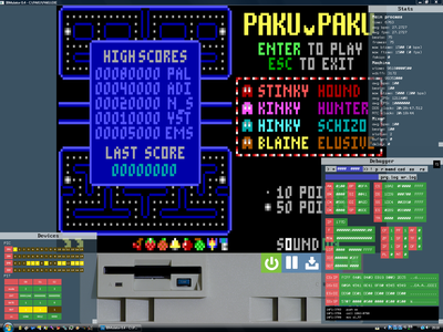

Has anyone played Paku Paku v1.6 lately inside DOSBox, PCem or even IBMulator lately?
Well...although the game is playable, I have encountered numerous bugs in Paku Paku v1.6:
1. Looking a the IBMulator v0.4 debugger, I've noticed that the DOS RTC clock drifts as much as 10 times faster than the RTC clock. This issue was also tested under PCem (Award Sis 496).
2. The power pellet (big white dot) only scores 10 points as apposed to 50 as advertised.

First off I've got a version 2.0 coming sometime soon that addresses a lot of the problems. It has a new timer codebase, uses coded sprites, and has a lot of other enhancements -- NO promise on a release date for that though as I've got a few other things planned.
There is a bug in the timer code, where I was setting 0xFFFF with an even divisor instead of 0x0000 with using fractions. That's where that drift comes from -- BUT, beware that in emulators (and on real hardware) that some timer drift is pretty much a GIVEN as soon as you actually start using the PIT for timing control. It's why the system timer on real PC's would ALWAYS go off from the separate RTC if you ran pretty much any game that didn't use "flat out execution" as it's runtime model. It's also why a separate RTC on things like the AST Six Pack were desirable (on top of the convenience of not having to enter the date and time every time the system booted). A lot of people made BAT files back in the day wrapping certain programs just to resync the PIT to the RTC. Remember PIT time drifts -- when you say "DOS RTC" that's NOT a RTC... what the PIT does drifts. Wasn't even consistent between 5150's made on the same assembly line since it was fed off a CRTC crystal that wasn't exactly precise either.

Reply 8 of 9, by ppgrainbow
Thank you so much for explaining all of this.
I knew that there was a bug in the timer code that caused the clock to drift so fast due to the PIT time drifts. I honestly can't wait for Paku Paku v2.0 soon.
