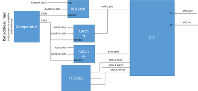

So far it seems pretty straightforward. I ordered an ISA photo board and a bunch of chips so I can try out some designs. Right now I'm mainly trying to sort out if a PIC chip at 32MHz will be fast enough to keep up with ISA bus timings, or if I need to add extra latches for the data (330h) and control (331h) ports. If it is fast enough, the card will basically be a MIF-IPC-A with a PIC chip attached to it.
Reply 17 of 608, by alexanrs
If you remember that the ISA bus runs at about 8MHz, having only four cycles per bus clock might be cutting it a bit too close. If memory serves me right, a read or write operation with no wait states takes four bus cycles, so you need to be sure to have the entire thing using less than 32 instructions. If you factor in Intelligent stuff, this might just be too little.
I'd try something slightly different. I'll try drawing something to help explain what I'm thinking, will post again soon.
Reply 19 of 608, by alexanrs
IMHO one drawback of that design is that the PIC still has to stop anything it is doing whenever someone reads from the STATUS port. This might be okay for UART, but I'm afraid wasting the PICs time doing that will cause trouble in Intelligent mode. This is a VERY rough drawing, just something I "scribbled" on PowerPoint. I guess that the example you provided could be adapted to what I'm thinking with the addition of another read latch specifically for the STATUS port, and I liked the way the address decoding is done there.
I made this drawing before really taking a look at that and without really taking a lot of things into account, as I just wanted to explain the what is in my head. The way I envisioned it, you can just update the STATUS GPIO ports during operation and the latch will do the job of returning it to the PC whenever someone reads it, without interrupting the PIC. I also imagine the software having two "queues". The three lines there (PORT&READ|WRITE) should trigger interrupts. Writing either commands or data would put them on the output queue, whereas trying to read from the data port would retrieve the "front" byte in the second queue (and update the STATUS port if the it is empty). The firmware's main loop would then verify if there is incoming data on the MIDI input port and add whatever arrives to the queue (and set the STATUS GPIO pins accordingly) and process the output queue (process commands and pass data through).
Oh, and i forgot about the interrupt. It would take another GPIO pin and a few jumpers to connect it to the desired IRQ. Then the firmware would need to assert it whenever it wants to trigger an interrupt.
