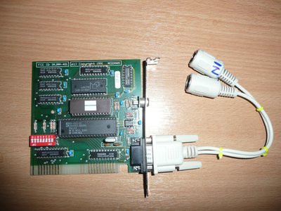

index.php?action=dlattach;topic=522.0;attach=460;image
looks like the midiman winman series didnt start till 1995 too.

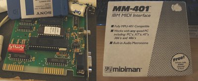

i also forgot that they also made an mpu-401 compatible, the mm-401
on one of the pics here its clearly visible dated as 1991
    2.35 MiB
    788 views
    210.1 KiB
    789 views

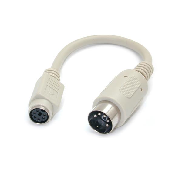

yes i intended on using a AT -> PS/2 connector/adapter for the keyboard..
http://sgcdn.startech.com/005329/media/produc … FCABLE.Main.jpg
and aswell having read tips from other threads on vogons i saw it was possible to wire a ps2 adapter from a pci bracket to the 4 pin header for the PS2 Mouse which is only on a few different boards with AT style keyboard ports.... maybe it was only on pentium boards with AT keyboard ports? but im hoping its included on these 486 boards that have integrated controllers.. so that i can use a modern mouse properly with the real socket 3 486 machine.
http://sgcdn.startech.com/005329/media/produc … LATE6F.Main.jpg

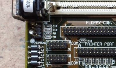

this pic may not be correct tho because that looks like a USB header and not this speical U-shape 4pin ps2 that was referenced in the thread i read
i think this one is correct:
the header is 2 x 4 with 2 pins missing (6 pins?) and is directly next to the AT keyboard port on the asus 486-sp3 board
http://imageshack.us/download/853/a5z.jpg
it says "ps2mouse" right near the header on the board aswell!
is this the only way to get a working ps2 mouse with a 486 board?
its not possible to use 486 cpus in socket 7 boards that have ps2 ports?
i read in another thread that a guy had to set a jumper to enable this ps2 support
and in another thread i read that to have this ps2mouse port there needs to be a seperate "keyboard bios" somwhere on the board

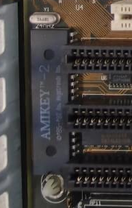

on the 486-sp3 i think its this big eeprom that says "AMIKEY" i have seen other boards that say "keyboard bios" on a chip
