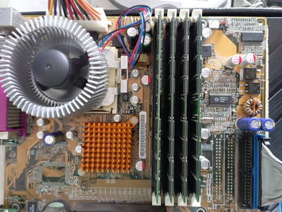

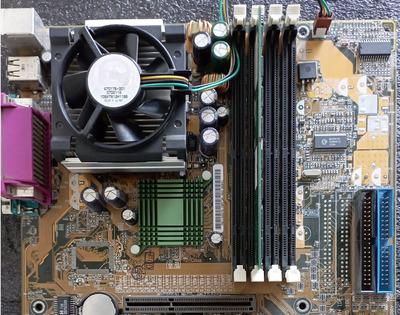

Reply 41 of 47, by shevalier
smtkr wrote on 2023-07-10, 02:41:
I recapped it and it didn't make a difference. I have a theory that it needs to have a hardware mod to bump vio, but I'm not going to mess with it.
What else does this motherboard need?
But, still 124MHz....
Against this
    1.31 MiB
    421 views
    1.64 MiB
    434 views

Reply 42 of 47, by BitWrangler
The actual heatsink on the northbridge should be helpful, those green things may as well not be there.

Reply 43 of 47, by smtkr
BitWrangler wrote on 2023-07-10, 12:34:
Since I'm using the BX6r2 as my daily [vintage] driver, I swapped in a much better heatsink (Replacement Northbridge cooler for Abit BX6r2) and I also put some heatsinks on the power MOSFETs (which were pretty warm when running 30W CPUs).
Some time in the next 10 years, if I'm still into this hobby, I'm going to figure out the resistor programming on the VIO circuit and bump up the voltage and see if that can push me to 133MHz FSB on this. The BX6r2 runs exactly at spec. I've noticed that my P3B-F (which can easily go above 133MHz FSB) runs VIO above spec and has the ability to push even higher with a board jumper.
