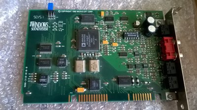

Hi Folks,
Got this card in the post today from a pal in the USA, apparently it does Soundblaster emulation for DOS as well as the windows stuff, anyonw have the drivers or further information, google has been rather sparse on this card.
Thanks 😀
Chris
Reply 1 of 16, by alexanrs
For Windows 9x and beyond, the drivers are built in, including Sound Blaster 2 emulation. For DOS there is no need to install drivers for games that natively support WSS, but you'll need drivers for the SB emulation. Not the best card for SoundBlaster gaming, though, as it does need a TSR AFAIK. Get them here

It's not really "emulation'... There's an actual Yamaha OPL3 chip on there, same as on a real Sound Blaster Pro.
It's just a hardware compatibility mode.

Brilliant!! Thank you very much for the help, what are the two jumpers one behind the other for?

This is a card with just a AD1848JP chip. You can lookup the datasheet and know all about it. This card, unlike others, does not have a separate controller chip between the AD codec and the ISA bus (like from Opti or Aztech or C-media). So what remains, is merely the windows-sound-system compatibility in hardware. That and an OPL3.

Read this. If its not some form of emulation than I'm not sure how different driver versions could change compatibility from the original SB to SB16. Also, if you look at the picture you'll see that, while it does have a codec (the AD chip), it does not have any SoundBlaster compatible IC there. Many SBPro+WSS clones have both the AD or Crystal codec and another chip as a middleman to provide hardware SBPro support.

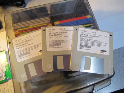

Here are the drivers I have, archived from original floppies.
267.19 KiB
1827 views
The more sound cards, the better.
AdLib documentary : Official Thread
Youtube Channel : The Sound Card Database
Reply 13 of 16, by BSA Starfire
Thank you very much Beegle 😀

Just a quick update, Got the card installed in my DFi Intel TX socket 7 board with DOS 6.2, Windows 3.11, all works great, Soundblaster compatibility has been spot on too, works fine with all the dos games I have tried(DOOM, CHAMP games, Xanth etc) and lots of old Demo scene stuff too, quality is very good, crisp clean & good range. I'm very happy with the card, it's a fair bit better than the Pine Crystal 4235 that it has replaced. Lovely having the 2 standard phono jacks on the back of the card too.
