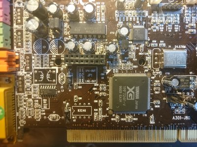

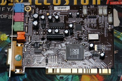

Reply 26 of 49, by j^aws
Tertz wrote:
j^aws wrote:
There are minor variations between YMF-724 cards: WaveForce 192XG (used as reference - YMF724E) is noisier than a clone I tested - YMF724F.
May you please place a picture of your 724F wich is less noiser than WaveForce? What codec chip is used on 724F? Were both cards in LineOut or speaker mode?
Here's an image from the web:
155.64 KiB
2245 views
Not sure on the CODEC differences off-hand, if any.
IIRC, the outputs compared were Speaker Out. One thing the Yamaha WaveForce lacks is SPDIF output. I've only managed to get SPDIF working via a Windows DOS session.
Once I make this a permanent build, I'll play around with it and feed it to some external DSP effects via SPDIF, and add Chorus/ Reverb / 3D Surround etc. to OPL3...

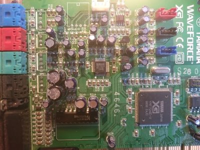

Reply 28 of 49, by j^aws
More detailed pics to compare chips:
2.81 MiB
2223 views
WaveForce
2.99 MiB
2223 views
Clone
Regarding compatibility: IIRC, I was testing various YMF cards, including an ISA YMF719, PCI YMF744 & 754, and the 724 remained the most compatible in my tests on a 440BX board. With the PCI cards, I was testing various drivers in Windows DOS sessions, so that SPDIF worked. The games tested were many installed on the test bench hard disk, but that has been wiped since. What I remember is regressing driver versions to ones that were so old that the 744 and 754 weren't recognised anymore. I didn't compare these cards in pure DOS due to my interest in getting the SPDIF working.
Reply 29 of 49, by Tertz
This 724 has Sigmatel stac9704 codec which with stac9708 are ones of least noisy on YMF7x4 cards.
