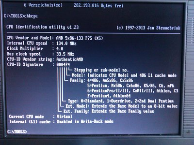

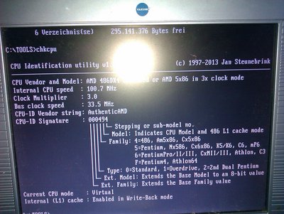

I have a 486DX4 SV8B in my Industrial PC,
now for fun i tried a Multi of 2x, now i end up with this :
Before:
358.55 KiB
1808 views
After:
2.99 MiB
1808 views
Looks like AMD relabled the 5x86 P75 to DX4 100Mhz ?

Not sure what you're trying to say. With AMD, 2x multiplier is used / interpreted as 4x.

Except it was detected as 5x, and the processor was then detected as a 5x86 by CHKCPU
You should run a few benchmarks to see if this is for real or a misdetection.

even the BIOS recognized it as X5 P75 and Linux Kernel 2.6.22 too.
NSSI CPU Benchmark is between P75 and P100.
Can you recommend CPU only Benchmark ?
i wanted to run run 2x50Mhz on DX4, instead i got this.

Some AMD 486 DX4-100 CPUs supports 2x and 3X multipliers, some supports 3x and 4x multipliers.
If you have 16KB L1 cache then your CPU is the same as a 5x86p75, if you have 8KB then its not the same even if its WB cache.

got 50.09 in Speedsys for CPU.

My 5x86 behaved in the same manner.
When I chose a multiplier of 3x, it recognised it as an AMD 486DX4-100 WB.
With a multiplier of 2x (or 4x), it recognised it as an AMD 5x86 P75.
Generally speaking, the 5x86 is nothing more than a 486 DX4-100 WB with an internal multiplier of 4x.
The 5x86 can also be configured for write through (WT) mode.

Your DX4 runs as 5x86, because it actually IS a 5x86 chip inside. Compare the package number on your chip with the information given here: http://www.cpu-world.com/forum/viewtopic.php? … er=asc&start=15

Yes, 5x86 and 'P75' are just marketing, in response to Intel's Pentium. Very similar to the PR rating that AMD put on their Athlon CPUs in the Pentium 4 era.
The CPUs were actually just 486-derivatives (which is why they perform so poorly in a game like Quake, which expects a true Pentium with a properly pipelined FPU instead of the outdated 487).
See also http://www.cpu-collection.de/?l0=co&l1=AMD&l2=5x86:
Introduced in November 1995, the AMD 5x86 is a standard 486 processor with an internally-set multiplier of 4, allowing it to run at 133 MHz on systems without official support for clock-multiplied DX2 or DX4 486 processors.
So software can't really tell the difference between a 486 and a 5x86, because they're the same chip. The software probably 'guesstimates' that it's a 5x86 because of the clockspeed and multiplier used.
