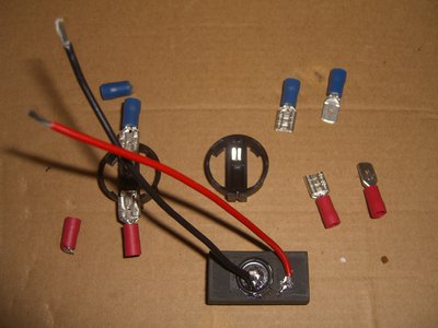

This version of the mod is easier done if your RTC is mounted in a socket or if you desolder it but it can be done with the RTC still soldered to the board with some masking.
The nice thing about this verion of the mod is that you do not need to care about what RTC pin goes where and such, the only thing you need to do is if you remove the RTC then make a mark on the bottom of the RTC chip to keep track of pin 1 as the mark on the top will disappear.
Wet grind with a sandpaper until you hit the battery, remove the battery and you will end up with a RTC looking like the one in the picture below. I think all batteries are mounted with + up and - down but take note of polarity when removing the battery just in case. I used cable shoes because the cheap CR2032 battery holder I got diddnt have much to solder on, the cables are unnecessary thick and long.

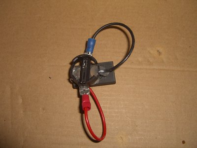

The cables soldered.

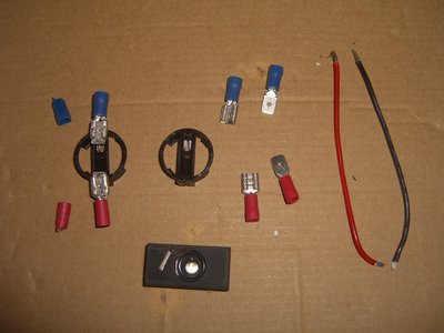

The battery holder glued to the RTC chip.

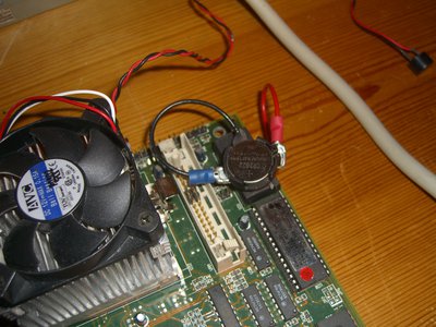

The modified RTC mounted on the board.

This is perhaps good to add.
I noticed that the RTC chip needs to be dried after beeing wet grinded, if its desoldered or socketed just put it in the oven at 70C for half an hour before soldering the leads for the battery holder. If the chip is still mounted on the board its better to leave the board in the sun and wait at least 24 hours even if you have masked the rest of the board well when sanding the chip. If you live in a country where the humidity is 100% and you dont have an AC then I think you could sand the chip down without water without risking it beeing damaged, I used water to avoid ESD damage.
I could not really figure out how the water got into the chip package but it did and the RTC did not function properly until dried.
