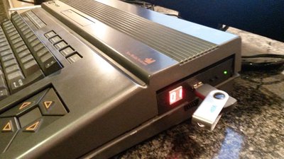

Reply 3 of 26, by seob
I use one of those for my msx2. It works great and is worth it's money.

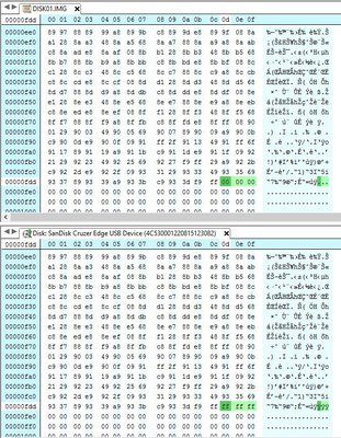

Reply 9 of 26, by Hailstorm
Hello,
I also have visited this forum on a regular basis and decided I should make an account. So here I am. 😀
This subject interests me a lot, since I too have bought a gotek floppy drive - and I must say, it took
me a while to get this d*mn thing working. It's a long story and if you skip this, I can't blame you.
Here it goess. First of all I managed to connect the device the wrong way,
resulting in a non-working disk-drive. But, as resourceful and patient I am, I kept fooling around with
this thing and voila, my machine accepted the drive and drive accepted USB-sticks. Happy end you would
think...
But now comes the strange part. Thanks to Philscomputerlab I knew where to find software to fill my
usb stick with images. Thanks Phil! Ipcas' software seemed to be a nice tool to manage the images on my usb-stick, so
I thankfully used the software. Added some disks to the usb-stick according to the explanation of Phil's video and
inserted the flash drive in my good old Pentium. The first disk should boot the msdos 6.22 setup, but instead in
stopped giving the error 'Non system disk' or something like that.
Thinking it could be the image, I downloaded another (bootable/setup) image from the internet, with a
non-msdos bootloader. Wrote this on the flashdrive again and booted up the Pentium. Although the error message changed,
it kept complaining about the fact the image wasn't bootable.
With a hex-editor I compared the first megabyte or so of the files and some differences showed up! 🙁 Don't
know where these differences come from. Could it be the combination of Ipcas' software and windows 10 (64-bits)? Who
knows. So, my conclusion is, ipcas software writes images to the disk, but then screws a lot of bytes.
It left me with a somewhat unusable gotek floppydrive.
The only thing I could come up with is writing my own tool. The past few days I've been programming my
own 'disk concationation tool'. With this program and an image writing tool, I got my gotek floppy drive
working. I was so freaking proud and excited when I saw 'Starting MS-DOS' appearing on the screen! 😀

Reply 14 of 26, by Hailstorm
]Let me first say that I am very happy to see that a few of you have interest in my application.
That means a lot, thanks!
To answer your question phil, I could try to upload an image of the comparison I made. That should make thinks
very clear, I think.
179.19 KiB
1718 views
This is may the most interesting one. IO.SYS gets overwritten, with the problematic effect that the bootsector
doesnt recognize the disk as bootable:
[attachment=0]diff2.JPG[/attachment
EDIT: It seems the data is shifted. Anyhow, it didn't work... 🙁
For the one who wants to use my software, please be aware the software hasn't been fully tested yet. Although I
would find it very sad if it didnt work out for you, I still can't guarantee it for everybody to work.
I have to make a few adjustments: I already got my first RFC 😉
I can have the first version uploaded within the first few hours.

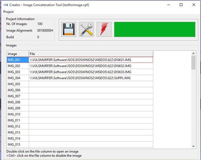

Reply 17 of 26, by Hailstorm
Ok guys, here it is. I hope this tool helps you gotek users as much as it did help me.
Phil, about creating 1000 images, my software supports that now. I am not sure though
if the format is correct (all empty slots will be filled with zeros).
Could you check that for me? I can't get the gotek drive to format my usb-stick... :s
    CreatorOne.zip
    955.19 KiB
    168 downloads
Reply 18 of 26, by Hailstorm
By the way, the program is quite simple in use and its self-explanatory. If someone needs help
however, please let me know. I also like to know if someone finds a bug or a weird error message,
since this program has still an alpha status.
Reply 19 of 26, by seob
Trying the software just now. But is it also possible to read a usb drive that is already formatted and has some images on it? Now i can only make a new project and it doesn't read the images on my usb thumbstick.
Also a little recommendation, the first image number should be IMG_000, the gotek counts from 00 to 99 when you have a 2 digit version. So images are offset by one.
Also i cannot see any of my msx disk images. They use the extention .dsk. Whould be helpfull to add a option so one can select any file with any extention instead of img and virtual floppy files.
When i add a file in the first slot and i select clear the filename and location is whiped, but the img size field isn't cleared.
The software also doesn't give a error when i make a 720k project and i load in a 1.44mb file.
Guess i'm not to smart to get how the software works, but what does the thunderbolt button do? It says it created a images but i don't now for sure.
