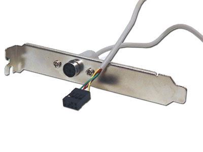

Reply 61 of 80, by vetz
Any ASUS PS/2 bracket will work on this bord. Its the same header as on their later Socket 5 and 7 boards
Reply 62 of 80, by chrisNova777
can u show a pic of what it looks like? so i can try to find one?

I'm speaking under correction but, I think that this motherboard uses this type of connector:
Reply 68 of 80, by jesolo
The one connector has one row of pin outs.
The other one has two rows of pin outs.
Not all the holes on the latter will connect to a pin on the motherboard but, they are the similar in terms of wiring (the layout is different).
I just highlighted that the layout of some of these connectors are different.

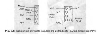

Apologies, I didn't look closely at your picture (was a bit unclear when I viewed it the first time).
Maybe this picture will explain better what I'm trying to highlight:
15.08 KiB
1020 views
PS/2 Mouse connector pinouts
This motherboard uses the one in the right.
Reply 72 of 80, by chrisNova777
jesolo wrote:
Nice motherboard. I have the exact one myself.
Only downside is that I still have older BIOS revision and my BIOS cannot be flashed (like newer motherboards). So, mine doesn't support the last Socket 3 CPU's (like AMD 5x86, Cyrix 5x86) but, I'm happy with the AMD 486 DX4-100 CPU in it.
Fortunately, I got mine with the PS/2 header and extension cable but, have a look on Amibay or eBay.
jesolo is there any possibility of you taking a couple close up photos of that ps/2 header + cable so we can see the pin orientation?

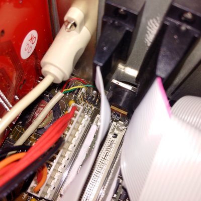

Reply 74 of 80, by BlackLinus24
@ chrisNova777
I had the same problem. This is what I found with regards to the wiring of the StarTech cables:
red - gnd
brown - data
yellow - clock
green - +5V
I plugged the individual cables onto their respective pins on the board and it worked with my Intelli PS/2 Mouse.

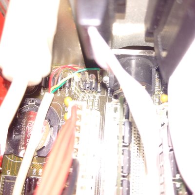

I was excited to try this just now but that configuration did not work for me
Here you can see I applied your scheme to the orientation illustrated on jealous pic and it did not work
The mouse driver installs it detects a mouse but there’s no cursor movement
if anyone can help id love to get my ps/2 mouse port working to be able to use a semi-modern mouse
like i said my system is FREEZING badly if i run anything after installing mouse.com with the mouse connected in this configuration..
but it DOES see that there is a mouse.. and lets the driver install... if anyone has a working PS/2 MOUSE with this MOTHERBOARD
PLEASE put me out of my misery and share a decent photo of your pin out scheme????????
i just found where jesolo found that pic and it was for a pentium 133mhz computer https://www.betaarchive.com/forum/viewtopic.php?t=23927
the pinout is NOT the same for this Asus 486 motherboard

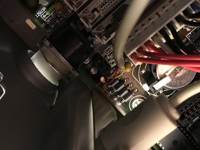

Reply 78 of 80, by BlackLinus24
Sorry for being away for so long. Here some pictures of my motherboard. I hope you can clearly see here which wire was attached to which pin on the PS/2 connector.
