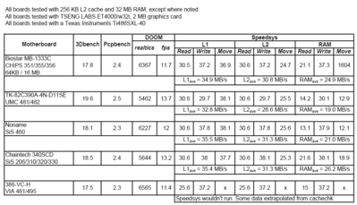

Since my old Abit FU340 motherboard died, I decided it was time to test my stockpile of 386 motherboards to find the best replacement.
I used a TSENG LABS ET4000/w32i as the test grahpics card and a Ti486SXL w/Cyrix FasMath FPU as the test processors. While I tried to hold 256 KB L2 cache w/32MB RAM constant, one motherboard was not reliable with more than 64 KB cache and 16 MB of RAM. This condition is noted in the chart.
The chipsets compared were:
CHIPS 351/355/356
UMC 481/482
SiS 460
SiS 206/310/320/330
VIA 481/495
AMI Mark V Baby Screamer (not yet tested)
The surprising outcome for me was that the motherboard which demonstrated the slowest RAM speed had the best benchmark results. The L2 score was not the fastest either. Click images for a larger, more readable, size.

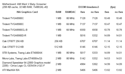

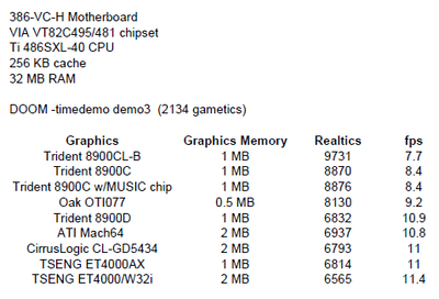

While running this motherboard/chipset test, I decided to benchmark my stockpile of ISA graphics cards. The results are as expected, with the ET4000/W32i as the winner. What was surprising was that a Trident 8900D (and only the D-marked chips) had DOOM performance similar to a ATI Mach64 and CirrusLogic CL-GD5434 (perhaps due to the CPU bottleneck?)

Reply 1 of 21, by brassicGamer
The Trident is really bad isn't it. I think I would like an ET4000 but they're quite expensive at the moment so I can wait. I've got an 8900C with the MUSIC chip - what's is significance?
Reply 2 of 21, by feipoa
I found all the Tridents to be either noisy or have verticle lines when running DOOM, or PCPBench. Perhaps there is a work-around for that? The Tridents with the MUSIC chip did not have this problem - in fact, they had very clear displays.
Reply 4 of 21, by feipoa
Yes, L1 is enabled. Some boards have L1 on/off option in the BIOS, while others I used software. I confirmed L1 is enabled based on the Speedsys L1 move speed and by using Landmark. Landmark always shows a big ALU speed jump when L1 is enabled, and a drop when it is disabled. The best Doom scores was 13.7 fps (UMC-based motherboard with ET4000/w32i). I was also very disappointed in the Doom results. Is there some trickery I need to do to the graphics?
Reply 5 of 21, by kixs
It very much depends on the BIOS setup. Wait-states, ISA bus clock, Video/system cacheable... the most you get by fastest cache timings and ISA bus dividers 1/3 or 1/4. Some graphic cards have problems with 1/3.
With optimized BIOS settings you should be getting around 24 fps in 3DBench. Don't know for DOOM - but check phil's spreadsheet.

Reply 7 of 21, by feipoa
Interesting. My best DOOM timedemo3 score was 5462, which is better than your results, however your 3DBench is much better. I do not understand this. For PCPbench, I am using VESA Modus 100 (640x400 8bpp LFB), which is what my program defaults to.
What are your Landmark v2 results for ALU and FPU? I get 130 for ALU and 185 for FPU.
EDIT: When I run PCPBench /VGAmode (320x200x8bpp) I get a score of 6.7 on my UMC/ET4000/W32i system.

Reply 9 of 21, by feipoa
I ran 3dbench again and received a score of 24.3 on the UMC system. I am not sure why it jumped from 19.6 to 24.3, however when I was trying to run 3dbench just now, it would hang up right when the program started, and a mouse pointer whould show on the screen. I disabled my mouse DOS drivers and 3dbench runs flawlessly now. Perhaps having the mouse drivers loaded in the autoexec was lowering my 3dbench score?
With sound enabled, I get 6950 in DOOM. Sound card is an ESS Audiodrive (ES1868F)

Reply 14 of 21, by feipoa
Attached are the ISA graphics card results from a VLSI-based 386 board. Click image for larger view. I've included the 0ws and non-0ws results because I noticed that cards cannot seem to handle 0ws in Windows 3.11. I am not sure if this is due to having too many ISA cards on the bus (SCSI, I/O, ethernet, sound, and graphics), or if there is one particular ISA card (perhaps SCSI?) which does not do well if the graphics card is at 0ws. Any ideas?
While the GD5434 card had the fastest results, albiet only marginally above the ET4000, it did not product as clear of a VGA image in DOOM and 3dbench compared to the Mach64 or the ET4000AX / ET4w32i cards.
