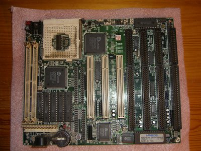

Reply 31 of 62, by Skyscraper
This is my UMC board, I found it on Ebay a month ago with an AMD DX4-120 but as the seller was a member here and on Amibay I bought the bundle outside of Ebay as I dont want them earning money from me when I can avoid it. I need to try it out anyhow so I might aswell see if I can get some decent scores 😀.
The board is a MG v1.1A. This model has also been sold as Ability, Amptron, Aristo, Eurone, Matsonic, Houston Tech, PCWare, Alton, Protac, Sybercom, Elpina, V.I.P, SOLAR COMPUTER, Hsin Tech, SYL, ST, TD and as you probably can guess... PC Chips!
Some versions seem to differ slightly but my board seems to be identical to the PC Chips M921 only with real cache. The jumper settings seem to be identical to the ones in the M921 manual. I can not find any settings for 60 and 66 MHz FSB but if the board supports those settings Im sure I will find them. I can not find any jumper settings for the AMD 5x86 either but except for the multiplier they should be identical to the settings for the DX4-120 so I do not think that will be a problem. [edit] I just read that the FSB jumper settings for the M921 are the same as on the Biostar-MB-8433UUD which member feipoa has mapped out. I also think I have identified the multiplier jumper for the enhanced AMD 486/5x86. I will start testing the board tomorrow as its a bit late now.[/edit]
The "MG" v1.1A. I do not know what has happend with the socket, its a "pre existing condition".
4.3 MiB
1556 views

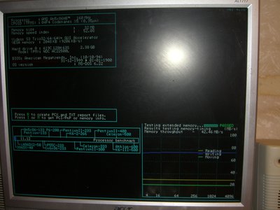

I tested the AMD 5x86 and the MG v1.1a UMC board a moment ago with mixed results.
The bad
I could not find any PCI divider settings in the BIOS so it seems I need to flash the PC Chips M921 BIOS to my board which should not be a problem as they are identical. Im just afraid the PC Chips BIOS will disable the cache as the PC Chips M921 usually had fake cache. The jumper I thought changed the multiplier diddnt and I have not had the time to find the correct one so the 5x86 is stuck at 3x.
The good
I did test the 50 MHz FSB setting and it seems to work great. No trouble with the IO-controller or the S3 Trio64 video card, at least not so far. Perhaps there is some auto PCI divider in action...
The first Speedsys result. AMD 5x86 @ 3x50 MHz. Notice the BIOS date. 10/10/1994, this BIOS is old!
3.99 MiB
1458 views

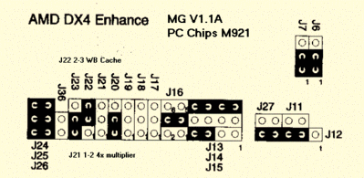

I managed to find the jumper that sets the multiplier for the AMD 5x86 on the MG V1.1A and I guess its probably the same on the PC Chip M921. I will upload the jumper settings here in case someone else needs them.
41.06 KiB
1433 views

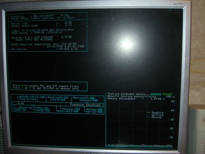

When I benched the MG V1.1A and the AMD 5x86 at 4x40 MHz I got a nasty surprise, the board had disabled both the L1 and L2 cache. I guess its because the BIOS is too old to support the AMD 5x86.
MG V1.1A + AMD 5x86 @ 160 MHz no L1 or L2 cache.
3.91 MiB
1432 views

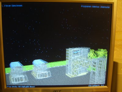

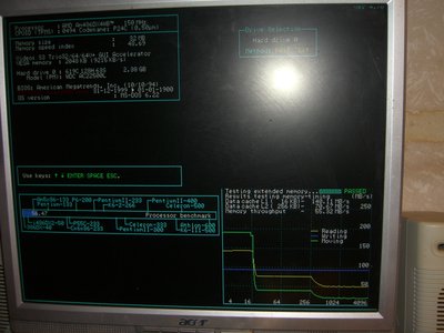

Then I switched back to the 3x multiplier and set the FSB to 50 MHz again.
Here is PCP bench VGA mode with the AMD 5x86 at 150 MHz: 25.2 FPS
3.7 MiB
1432 views
PCPbench Mode 100, AMD 5x86 at 150 MHz: 10.8 FPS, only 0.2FPS better then the Intel DX4 at 120 MHz*.
3.57 MiB
1432 views
*Using the Asus PVI-486SP3 and a Matrox Millenium II
I also tested to see if I could get the 60 MHz FSB setting going using the AMD DX4-120 which has 2x and 3x multipliers but it would not even post at 2x60 MHz with the memory, cache and ISA-bus at the slowest settings. Im now sure this board dosnt use any auto PCI dividers, if Im going to get the PCI-bus to run any other divider than 1/1 I will need a new BIOS.
