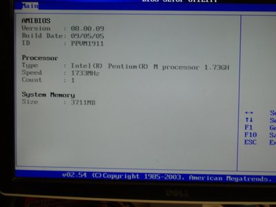

Anyhow...I just figured out something with the PAE situation. Apparently it DOES work. Sometimes. If I do the right things to make it so. Or rather don't do the wrong things. Of which I'm not entirely sure what those are. But I digress. Long story short...it has something to do with how I configure my BIOS settings after clearing the CMOS. After resetting the BIOS it suddenly shows the extra ~400MB I spoke of.
In the BIOS.

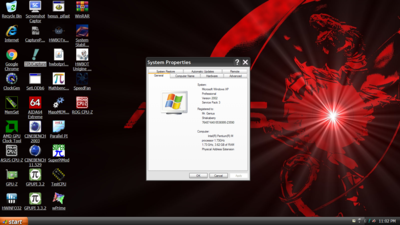

And in Windows.

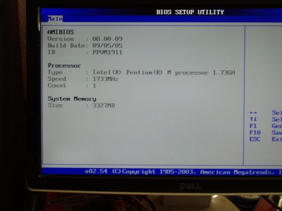

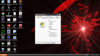

Not sure how I never noticed that until now... 😕. I could swear I tried that before and it did nothing. But like I said, I can make it NOT work by changing some BIOS setting(s). I can't think of which one(s) it would be. All I know at this point is it isn't setting the date and/or time.
Here's what that looks like.

BIOS tweaks probably can free up some reserved address space.
Unfortunately both 875P and 945P/G chipsets does not feature address remap over 4 Gb. PAE is completely useless too, due to the 4 Gb hard limit of the chipset and no support for buffered modules (2gb).
