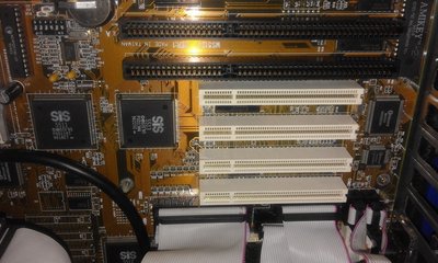

Without the entire board it is harder to identify the correct model, and once it is identified it is not impossible (or even rather easy, depending on the maker) to get the manual which will provide the pinout for all headers.

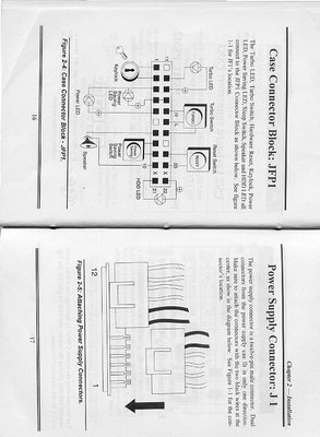

If that is how it is shown in the picture I can't argue with that. Also, polarity isn't important for speakers and buttons, and reversing LEDs won't hurt either (but they won't work).
Reply 26 of 37, by Caluser2000
have another look at the picture I posted earlier. Blacks go in the center...
Reply 28 of 37, by Caluser2000
You should be able trace where they came from. As for where they go on the mobo have a look at page 16 of the manual alexanrs linked to.

Reply 30 of 37, by Caluser2000
Hook the HDD led to the two pins on the end where the gap is and see what happens.

Reply 37 of 37, by alexanrs
Check every component on its own, specially the video card and memory. Be sure to hook up a speaker to the motherboard, as it will beep if the motherboard detects errors before initializing the video hardware.
