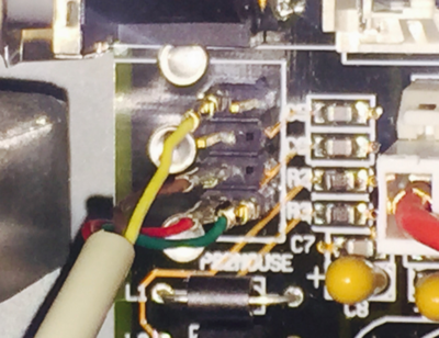

Reply 22 of 100, by chrisNova777
ive totally unplugged the wires from the black connector + im just attaching them directly to the pins to try to figure out the pinout that works.. so far no luck
Reply 23 of 100, by chrisNova777

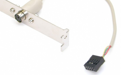

cmon guys im using a commonly used part.. the startech plate6F connector.... someone else must have used this. and has figured this out already... and will have the exact same header with the exact same wire colors (red, yellow, green, brown) PLEASE HELP ME i want to be able to use my computer!! i havent even been abel to use it since i bought it some 3 weeks ago.. this is killin me

Reply 25 of 100, by chrisNova777
firage wrote:
A little bit of a long shot considering how companies work these days, but you could try to get the pinout from Startech's support.
that really doesnt help me.. i need to hear from someone else who has the plate6F reconfigured. there are a number of people here on the forum that have done this.. artec is one of them. vetz is another.
i dont understand how he (artec) ended up with a 2x4 connector when he ordered the same thing i did.. PLATE6F from startech..
http://www.startech.com/media/products/PLATE6 … F_Datasheet.pdf
the datasheet doesnt show the pin out but it does say that one side of the connection is 10 pin.. not 8..

Reply 33 of 100, by Imperious
I think an easy way to figure out the pinout on that startech ps2 connector would be to use a multimeter on ohms setting and put a pin in both ends
of the thing and measure until You find out whats what. You already have the ps2 mini din pinout. All You need to figure
out is what the wires are at the connector end, then remove and refit where necessary.
You should also be able to use the multimeter to figure out what pins on the motherboard are 5v and which one is ground, that will narrow it down a bit.

Reply 34 of 100, by feipoa
If your header to DIN pins are correct, then ensure that your BIOS revision has PS/2 mouse enabled. You can use MODBIN to open an image of your BIOS on another computer. Also, ensure that the version of the keyboard controller chip on your MB supports PS/2 mice. Not all of them do.

Reply 36 of 100, by chrisNova777
i dont have a multimeter.. is there not anyone who can help me figure out which pins are which? is there not anyone else who has a plate6F from startech.com?
artex said he had ordered one but his wires were different color + diffrent pin header size (2x4 8pin vs the 2x5 10pin i recieved)
artex says this is the layout that worked for him: PS/2 Bracket for Asus Motherboard Header
but like i said he got a different item iwth the same model number somehow from the same company..
here is a pic of the adapter he got:
on his connector his wires were as follows:
blue=gnd
red=data
black=VCC+5v
green=CLK
and the asus layout depicted in the manual for a later pentium board was listed as :
file.php?id=20469&mode=view
my adapter has yellow,red,brown, + green wires (as seen in attachment to show wires only, this wire config did not work for me but neither did switching red + brown wires position either!!!! so this pinout must be totally different!)
    1.02 MiB
    624 views

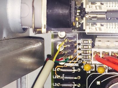

Reply 37 of 100, by chrisNova777

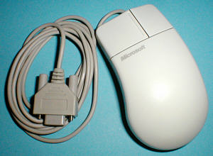

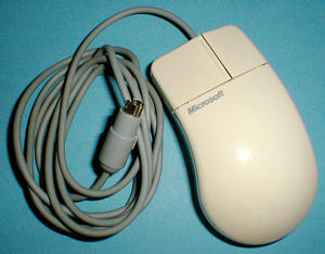

this youtube video notes that the mouse i have *IS* serial compatible!! perhaps then my ps/2 to serial adapter is wired differently for a different mouse? and if i had the one in the video that it would just work!!!
i think the adapter for ps2 -> serial that i have is for a "Microsoft Mouse 2.0" because its grey..
ms mouse 2.0:
16.06 KiB
621 views
ms mouse 1.0:
14.68 KiB
621 views
could it be that there is a difference in wiring between the labtec 3b mouse + the microsoft 2.0 mouse so much that it would render the mouse not workable via serial?

Reply 38 of 100, by nekurahoka
chrisNova777 wrote:
... i thought the header was on backwards ive tried putting it on in any orientation that it will work..
This is probably your problem. Trying the header on backwards can ruin the port.

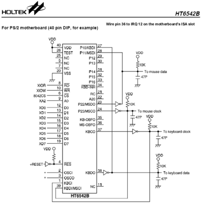

Reply 39 of 100, by feipoa
Get yourself a $5 multimeter to determine exactly where the coloured wires are going onto the DIN. Determine exactly where the header pins are going to on the keyboard controller (KBC) chip. You can then determine which header pins are what (Vcc, GND, DATA, & CLK) by where they go onto the KBC.
29.25 KiB
596 views
Ensure that your KBC has PS/2 mouse support. If it is AMIKEY-2, for example, it has ps/2 mouse support.
Ensure that your specific BIOS revision has PS/2 mouse support. The power management mention of IRQ 12 means nothing in this regard. You may need to open a soft-copy of your BIOS image with MODBIN to ensure the PS/2 mouse option is checked. If you like, you can send the imgae to me and I'll open it with MODBIN.
