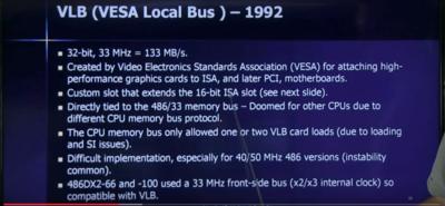

im starting to think this is weirdness because im using VLB cards in a machine that has a DX2 80Mhz CPU that runs at 40mhz .. that ive clocked to 33mhz using the jumpers on the board to maintain VLB stability. rather then a DX2 66 or DX4 100 cpu that runs at 33Mhz. while i cant confirm the ps/2 port because ive yet to get the correct wiring.. the serial ports seem to not function properly at all.. either they are damaged/blown or something is causing them to function improperly. ive gone thru all the steps software wise.. tried a million different jumper settings + driver switches.. im thinking all the wierdness might dissappear if i had a native 33mhz cpu. (see attached image + linked video https://www.youtube.com/watch?v=qla-5isbK60 @ 9:00 min mark)
608.85 KiB
340 views
