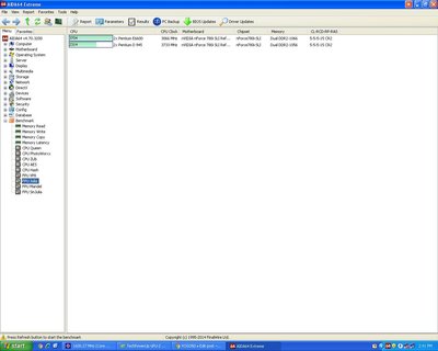

C1 stepping, SL9QB
Unfortunatly my E6600 is not a Conroe, but a Wolfdale. I was sure I had a Conroe. No matter, the wolfdale is clocked at 3GHz and has 2mb cache while the Conroe has 4mb and is clocked slowe at 2.4GHz. I guess I can emulate a C2D e6600 by disabling two of the cores form my Q6600.
In the mean time, here are some results: *the pentium D is running at 3.74GHz (220x17) while the e6600 is running @ stock
CPU Queen:
2x E6600 = 12869
2x Pentium D 945 = 5512
CPU Photoworxx:
2x E6600 = 3101 mpixel/sec
2x Pentium D 945 = 2603 mpixel/sec
FPU VP8:
2x E6600 = 1816
2x Pentium D 945 =1276
FPU Julia:
2x E6600 = 3704
2x Pentium D 945 = 2314
