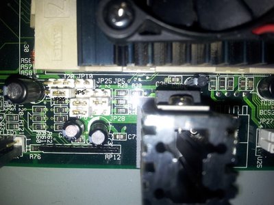

Managed to pick up this Pentium 1 machine from work that was due for the bin. Turns out to be a Pentium 75mhz with 8 megs of a ram and a S3 trio card.
Fairly basic but what's interesting to me is it's actually the first proper retro OEM machine that doesn't have a locked down motherboard - it has a BIOS full of options and jumpers to set FSB, cpu voltage and... multiplier..I think?
I'm basically replacing the 75mhz CPU (http://www.cpu-world.com/CPUs/Pentium/Intel-P … 0A80502-75.html
with this 133mhz chip - www.cpu-world.com/CPUs/Pentium/Intel-Pe ... -133).html
But I'm not sure how to set the multiplier on the board. I've changed the FSB from 50 to 66 which has got the cpu running at 100mhz but it's obviously still running at a multiplier of 1.5 - I need to set this to 2.0
I can't figure out how to set this.. could someone help? Here's two photos of what I *think* it is I need to change, but I'm clueless on how to set the jumpers. The board seems to be an Intel 82430FX TRITON

I think you need to set the "CPU INT SPEED" to "1/2".
Jumper on JP10, no jumper on JP5. EDIT you need to add a jumper as JP5 is already empty.

Reply 3 of 11, by Skyscraper
sirlemonhead wrote:
thanks 😀 Any idea which one is JP5? I'm a little confused by the labelling...
I edited my message but you were too fast. 😀
My first edit was not the best advice though. You need to find a spare jumper as JP5 is already empty. I edited my post again.
I agree that the labeling is very confusing.
Note that the row of jumpers on the right are all JP28 and sets the V-Core eventhough it looks like the first jumper is JP25 and the second JP5. This is very bad design eventhough this motherboard cant set any voltages that are dangerous for the CPU.
This is how it probably is.
But this says that your board is jumperd for 2.5x at the moment which seems strange. Perhaps they have for some reason used 0 to equal "jumper" and 1 to equal "not a jumper" which would make this setting 1.5x and a jumper on JP5 will make it 2x with JP10 still empty. I would try this!

Reply 4 of 11, by sirlemonhead
Jumpering JP-5 has the Bios reporting a 133mhz CPU so that's looking good. Thanks! 😀

Reply 5 of 11, by Skyscraper
How does the 2/3 and 1/2 values relate to the multiplier?
2/3 is FSB "2" CPU "3" so the CPU = 1.5X FSB
1/2 = FSB "1" CPU "2" so the CPU = 2X FSB
2/5 = FSB "2" CPU "5" so the CPU = 2.5X FSB
1/3 = FSB "1" CPU "3" so the CPU = 3X FSB
Totally not logical 😀

Reply 8 of 11, by idspispopd
Skyscraper wrote:
2/3 is FSB "2" CPU "3" so the CPU = 1.5X FSB […]
They just show the divider instead of the usual multiplier.
3/2 = 1.5
2/1 = 2.0
5/2 = 2.5
3/1 = 3.0
Consistent, arguably logical, but not using common conventions.
