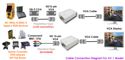

Reply 22 of 60, by chrisNova777
i found this gif that kind of explains how to hook up rgb to modern vga devices
on this ebay auction page: http://www.ebay.ca/itm/15Khz-RGB-CGA-Componen … 1QAAOxyGStRvpjd
ive attached the gif
basically it says u need the db9-db15 cable ASWELL as this funky converter box .. and another normal svga cable to go from the box to the monitor/display

Reply 23 of 60, by Scali
The big problem with that is that the arcade world thinks that CGA/EGA is the same as the analog RGB output by most old arcade machines and consoles. It is not.
"The CGA outputs from those arcade game board or older Amiga computers can now be output a desktop LCD monitor for display."
Erm no? An Amiga outputs analog RGB, which has nothing to do with CGA. The signal is basically the same as VGA, just at a lower frequency (no line-doubling).
As mentioned often enough before, a box like this works, but only if you include a custom DAC circuit to convert CGA/EGA's RGBI signals to the proper analog RGB signals.

Reply 30 of 60, by alexanrs
That box will only work with a custom DAC (I actually made one of those, I only need the box now for my 8088). Getting a cheap VGA card should be simple.

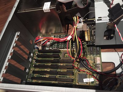

Reply 31 of 60, by chrisNova777
Mobo
    1.17 MiB
    873 views
    1.68 MiB
    874 views
