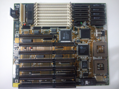

I'll keep this as short as I can (warning: can be wordy *sorry) I have also attached a photo of the board.

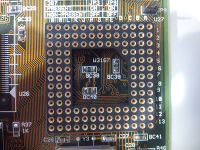

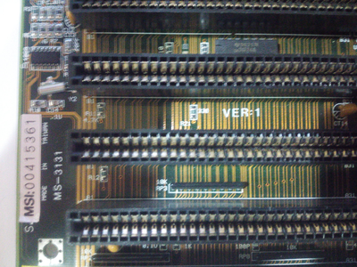

I've been given a stack of am386 dx-40 (soldered chip) boards. I have been doing some extensive research to figure out what these were, where they came from, and what was their intended purpose. The boards are all the same and are UMC chipset based, along with having a am386 dx-40. However, there are two extra sockets located on the boards. One socket says W3167, which I'm assuming is for a weitek processor of some sorts. The other socket, strangely enough says...PGA 80286. The closet thing I have found to this board is a board made by Computrend Systems INC, located in Taiwan. Unfortunately the board is a little different, its listed as MS-3131 Ver 1.1, and is missing the extra processor socket. Mine is MS-3131 VER:1 with an extra socket, otherwise the board layouts were pretty dead on. Also there are two youtube videos with this very board, but minus the extra processor socket. They all have a 80MHz oscillator chipped attached to the boards, they seem removable, except for two boards, which have them soldered on. Also it seems they have a 14.311818MHz oscillator as well (guessing, looks identical and same brand). I'm restoring these boards and plan on making functional systems with them, I'm hoping these are some what of a hotrod 386 board that will do well with some cool DOS games 😀 😀 😀. ANY information would be so greatly appreciated, again, I have found ZERO matching information online about these boards, or anything else like them. I have found other tri-processor UMC boards that included a soldered am386, weitek socket, BUT a 80386 port, instead of the labeling 80286 which I have.
Basically, what do I have, what kind of coprocessor should I pair with it, aaaaand whats my best performance options....?

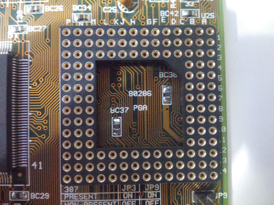

Reply 3 of 43, by PCBONEZ
I think it is simply a matter of you having version 1 and the link showing version 1.1 so the drawing doesn't match exactly.
I also suspect that 80286 marking is simply an error. (Not unheard of.)
80286 CPUs only have two rows of pins down each side.
That socket has three rows which is consistent with an 80386.
Also the chipset suggests 386.

Thank you everybody for replying so quickly. So, if the other socket is indeed a 80386, does that mean this is some type of dual socket board that probably has next to no support for that feature? The boards came from the college I attend, we're working on a project to restore all of these into functioning pc's to put in a interactive display for computer science students. I'm thinking these will be interesting to document due to their fall out features.
It is definitely NOT a dual CPU board. It only has support for two different types of 386 CPU packaging. This is quite advantageous (if your BIOS supports it), since it will allow you to upgrade the system with 486DLC class CPUs or even (I don't know why, but well..) something like Intel RapidCAD.
Although it will not hurt, CPU cooling was almost unheard of in 386 era, their operating temp rating is quite high, their TDPs are miniscule.

If there is not a jumper to disable the onboard CPU, chances are it would have to be sliced off in order to take advantage of the PGA socket. Usually they leave the PGA socket off the board if the PQFP cpu is present, but sometimes they make mistakes and give you extra parts you can't use.
Reply 13 of 43, by feipoa
Do you have photos of the other 7 boards you got ahold of?
If you are going to build your case out of wood, keep in mind that metal casing is typically used to provide EMI protection. So if you are going to use wood, at least line the inside of the wood with aluminum foil and ground it to the motherboard/PSU's ground.
My UMC-based 386 board has very good bus throughput, although the main memory throughput tested on the low side. Your chipset should support 486DLC and 486SXL CPUs, however as Anonymous Coward noted, you will likely need to cut of your QFP AMD DX40 chip. I had to do this on my UMC-based 386 board.
The good knews is that the board you have is branded by a major motherboard manufacturer, MSI.
