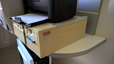

Reply 1 of 13, by alexanrs
My XT build is currently on the case I bought a 486 system with. You can see it in this post. It is 40cm wide and 39cm deep. It looked very out of place housing a late PCI 486 because it has two IDE LEDs, as that motherboard has a single LED header that signals the activity of both IDE channels. It also looks way too modern for a XT, but it works. Here are some more pics:

I find it hard to believe you'll find anything much shallower unless you find a case very cleverly designed. There is almost no space between the 5.25" drive bays and the PSU in this case.
Reply 2 of 13, by carlostex
My Seasonic PSU is 13.9cm deep and the TEAC 5.25 floppy drive is 20.5cm long so there's still a few cm left for cabling.
The dimensions of your case would be perfect for me and it seems that i could even live well with 40 x 40cm. Kixs has a case at amibay with 40 x 40cm but unfortunately is not a full height case and it doesn't bear a power button. I have to keep on looking, because i really lack space. I could then put my monitor on top of the case and my mixer as well.
Pretty cool case alexanrs. I don't really care if a case isn't period correct and the 2nd LED could be cool for something else.

What I meant is that, since the PSU in this case is pretty standard-sized for its time, so I find it hard to believe its gonna be easy finding cases shallower than that. And yeah, I like this case! With the old Deskpro that used to be in its place I had a hard time leaving a second system plugged in and still have enough space for my hands/arms, now it is perfect!

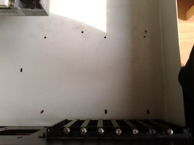

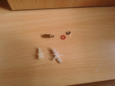

Reply 12 of 13, by tyuper
carlostex, can you take detailed photo of these plastic standoffs in your case and measure its height? I have similar case and can't find any fitting standoffs 😕
