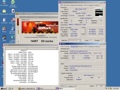

Reply 8 of 34, by Imperious
Those benchmarks make me pretty happy with what my old Motherboard can do, especially considering Via 686A chipset with SDRAM. It's giant overkill for what I've been running on it though.

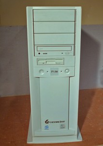

Reply 19 of 34, by computergeek92
I've decided to go with the 754 board. Chipset is VIA K8T800. Hopefully it's still there on Friday. I'm planning on maxing it out with the 3700+ and 3GB DDR 400 plus a 320GB sata hard drive. The surprise is my case will be the legendary Gateway 2000 P5-200 full tower! I found the best board that will fit the semi-proprietary built in ATX IO shield. Next I need to find the best video card for this system...
Here is what the monster case looks like:
http://i.ebayimg.com/00/s/MTMwM1g5MjU=/z/sYsA … FVlGoF/$_35.JPG
