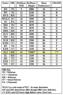

ZLJ is an odd series because their ESR is consistent with Rubycon ZL, Sanyo/Suncon WX, Nichicon HD and Chemicon KZE.
(Those are about 2 grades lower than what I suggested.)
BUT, the ZLJ ripple rating is darn close to those I suggested.
ZLJ is a pretty new series and the others I've mentioned have been around for ages.
The Rubycon ZL, Sanyo/Suncon WX, Nichicon HD and Chemicon KZE are most likely perfectly fine on that board. (And so would KZJ be.).
Any of those (except the KZJ which is too new) were commonly seen on early P3 boards, particularly those with lots of caps like yours.
In other words they should be fine. I was failing up a little bit to keep away from the lower limit - so to speak.
I will make up a little chart and post it so what I'm saying makes more sense.
Might be a little bit. The wife is in my hair.
Reply 11 of 14, by PCBONEZ
Okay, the attached is a very slimmed down version of a large comparison chart I made for my own use.
The 'Grades' are my own creation. I don't think anyone else uses them. Probably because I've never published them before. 🤣
The grades make it easier to have a conversation about caps, so here they are.
To compare (cross-reference) one brand/series to a different series disregard the uF and voltage and look at the can size.
This is because -within a series- all with the same can size have the same ESR and Ripple ratings.
In my full blown chart I use 8x20mm, 10x20mm and 12.5x20mm as those are common and found in most series.
Your board appears to only use 8mm so I'm only showing 8x20mm here.
The caps are (generally) sorted by ESR first, then Ripple. Those that seem out of place are so because the 10mm sort is different.
Endurance is disregarded for the grades because from a practical (real world) standpoint it's not a useful number.
- As you can see the ZLJ is an odd one.
In the 8mm sizes ZLJ series ESR is consistent with grade G but their Ripple is way up to grade C.
Not shown but their 10mm ESR is worse than grade G and their Ripple would put them in grade F.
Anything grade G or better should work fine on your board. (I doubt any Tayeh was better than Grade G.)
If you are going to go all the way to grade A or B then you might be better off going with solid polymer with an ESR around 10 mOhms.
103.17 KiB
447 views
ESR is in milliohms and Ripple in milliamps.
