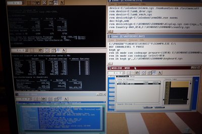

The Bios has no Option for Deactivating ACPI, but I think I can deactivate it in Win98se
Dos=high does not work. It's alway vmm32.sys activatet. If I add himem.sys to the config.sys
it simply does not change anything.

I don't think you can deactivate ACPI in Win98SE once it is already installed. The only way to do it is during installation:
setup.exe /p i
Reply 43 of 46, by dr.zeissler
I changed the config.sys. "Emm386 ram I=b000-b7ff i=e000-efff frame=e000". Now it works with ems.
