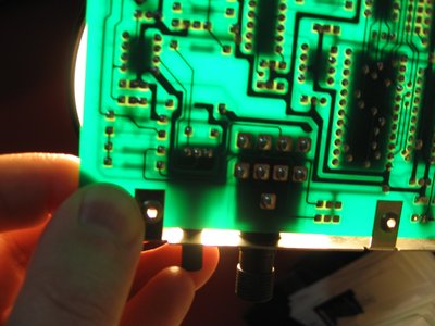

I got a now defective original AdLib (the PCB is dated 1987!), which I bought a few (... more like 15) years back on a flea market for beans, when these things had practically no value. Originally it worked, but then shortly after I bought it we cannibalized the volume potentiometer from it for another project. The rest of the card is untouched, and was lying in a box ever since.
Recently I found it, and had the idea to revive it if possible. And then maybe even build a small 286 or 386sx config around it. We'll see! 😀 This earlier AdLib repair topic here at Vogons was a great source of info, but I cannot seem to locate the required potentiometer for it. Anyone has any idea where to get the part (or an equivalent replacement for it)? I'm not an electronics guy, but I could get the soldering done, but I spent a day or so looking for the part online, but I couldn't find it (or it's maybe just not obvious for me that a given part would be a good replacement). According to the other topic it's a "10K audio volume control pot from Bourns".
Anyone has an idea where to get this thing? Or is it even still possible to get it? Thanks!

Potentiometer seems to be the same on both 1987 series and 1990 series.
I can read something on the side of the blue 1990 potentiometer :
91D1DW32D15
10K MEXICO
J9139X
I can't read much for the 1987 potentiometer, it's blocked by the 1/8 headphone jack.
Edit :
Adding a picture of an 1987 AdLib under a light, to see how many connections that potentiometer has, and the distance between pins.
764.39 KiB
1338 views
So there are only 3 pins, that's a mono potentiometer. They are pretty close together too, between pin 1 and 3 there are 5 millimeters.
Also, the pins are in a row that is perpendicular with the knob itself.
Searching for a match or equivalent, will report findings.
Edit 2 :
Part number 91D1DW32D15 seems to indicate that this part is not produced anymore.
Closest equivalent seems to be this one, in regards to size, shape, position of pins, and distance between pins :

Reply 2 of 14, by PCBONEZ
That ebay one is not so great a match IMHO.
The original is audio taper. The eBay one is linear taper.
91D1DW32D15 is also written 91D1D-W32-D15
It's a Bourns model/series 91. https://www.bourns.com/pdfs/90SERS.pdf (updated)
These are 5/8" square.
51AADB28B15 is also written 51AA-DB28-B15
It's a Bourns model/series 51. https://www.bourns.com/pdfs/50.pdf
These are 1/2" square.
The PDFs have part number decoders a page or two down.
91D1DW32D15
91 - Single Turn, In-Line PCB Pins
D - 3/8"x3/8" bushing, unthreaded (updated)
1 - Single Deck
D - No Anti-rotation Lug
W - Plastic Shaft, Knurled, 1/4" Diameter
32 - 1" Shaft Length
D - Clockwise, Audio Taper
15 - 10k Ohm
51AADB28B15
51 - PCB Pins, 0.1" On Centers
A -3/8"x3/8" Bushing
A - Single Deck, No Detent
B - Slotted Shaft, 1/4" diameter
28 - 7/8" Shaft Length
B - Linear Taper
15 - 10k Ohm

Reply 6 of 14, by PCBONEZ
Any with threaded bushings (threads to panel mount them) may have issues fitting through the hole in the card's back-plate.
Measure carefully.
Reply 7 of 14, by PCBONEZ
http://www.mouser.com/search/ProductDetail.as … y91A1A-B28-D15L
http://www.digikey.com/product-search/en?mpar … D15L&vendor=118

Ok, so... just to make an update since there was progress... It turned out I wasn't exactly in a hurry with this (...), but two weeks ago finally ordered the part. I got it in mail yesterday, and by today it's even soldered to the card. 😁
Pictures: https://twitter.com/chainq/status/1056245130255052800
To be seen if it still lives... But at least it's complete now!

It works! 😁 Also the volume control works as expected.
First I thought it was dead/buggy, because most software had glitches (but some, like Prince of Persia worked) but then it turned out for some reason I had to disable the clock doubler and/or caches on my Make-It-486 (TI 486sxlc/40) upgrade in the 386sx/20 where it lives. After this, all software I tried (PoP, LHX, Indy 500, Prehistorik, few others) sound as expected. I wonder there's a workaround for this, or indeed, this box is just too fast for the AdLib.
