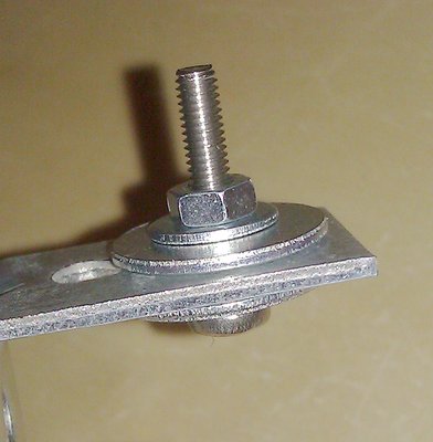

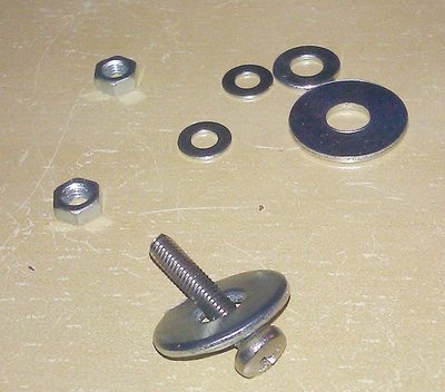

Reply 4 of 12, by adalbert
If this is a propertiary standoff model it could be hard to buy. You can try designing and 3D printing similar part (with a hole in which you could place a metal nut), it shouldn't be expensive nowadays (I don't know how much commercial 3d printing services costs, but I managed to build a 3D printer myself for equivalent of 150 eur and the plastic filament for that single part would cost only something like 0.2 eur.).
But i think that you could try a cheap DIY-solution with bunch of M3 bolts, nuts and washers. You could use wide washers and nuts to mount a M3 bolt in the place of that rectangular hole, then just install the mainboard and put a nut on the standing out screw. I just grabbed some things I had lying near the desk and made photos of this solution. Imagine that this metal piece with holes i'm holding in hand is your case 😜 you could add or remove some washers to adjust the height.

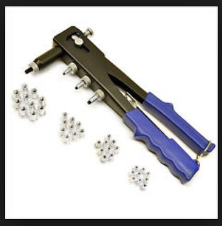

I had a similar situation where I had two identical cases I like but only enough of the square stand-offs to outfit one of them.
I looked for the correct stand-offs for YEARS and never found any.
In the end I used these things called nut-rivets. They are a type of threaded insert.
They are basically pop-rivets that leave a threaded hole. (A special rivet gun is needed but it's not expensive if you shop. The rivets might even cost you more.)
[case]
I found some that fit the square holes nice and tight and that left 6-32 threads so I can now use standard stand-offs.
I went out of my way to find steel nut-rivets (most are aluminum) in case I had back-up by also soldering them into place. Didn't need to.
For some cases you may need to shorten the brass stand-offs to compensate for the thickness of the rivet head.
The rivet gun has a threaded shaft that you thread the rivet onto. It then pulls by the threads to 'squish' the rivet into place.
The guns usually come equipped for several thread sizes.
You can actually get by without the rivet gun by using a long enough bolt and some stacked washers but it's kind of a PITA.
