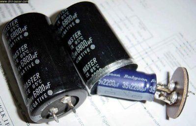

Reply 50 of 54, by PCBONEZ
Another example. This pic is a classic. Been around the web a while. IIRC it was an eBay purchase.
56.27 KiB
718 views
Reply 51 of 54, by gdjacobs
I love how the real cap inside the fake is a knock-off anyway. Rulycon, indeed!
