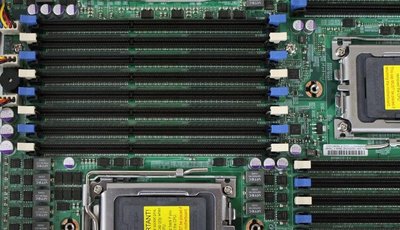

I agree with that.
I think what happens is people see server RAM with heatsinks and they think: "Oh goody. If I get RAM heatsinks my RAM will be heavy duty just like server RAM".
What they miss is that server RAM slots are normally spaced (estimating) 3 or 4 mm apart specifically to allow room for airflow between the heatsinks. (See attached pic).
But consumer boards tend to have some of the RAM slots smacked right up against each other like shown in the Opening Post pic. No room at all for airflow on one side.

That and servers often are in small cases with little ventilation (blade server) And servers have a different type of load too.
Your gaming PC is not going to have ECC ram and sure is not going to be maxing it out 24/7 like a server might be.
Anything more than a strip of metal is a waste, but some just like the looks. For me a system full of shinny cooper looks cool when done right.

Ah, yeah. I've built servers that use 128 Gb RAM. I've never messed with dedicated gaming machines. (For that sh*t, I'm here to learn.)
Even small chassis servers have a lot more airflow than consumer PCs. They use high capacity fans and ducting.
Blades like I think you mean use cabinet cooling with high capacity AC fans.
ECC and Buffered is not the same thing BTW.
I would rather have it be cool than look cool.
The problem with exposed copper is it is usually either coated with something (which hurts cooling) or it oxidizes and looks like crap fast.
