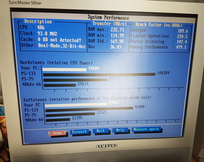

Reply 23 of 64, by mt777
I tested several options to maximize results.
Bios from EFA 4DMS works but performance is much worse than original from Asus.
Cyrix 120GP, 1MB cache.
    344.15 KiB

Reply 24 of 64, by techweenie
feipoa wrote on 2015-12-22, 20:43:
I have been testing an Asus VL/I-486SV2GX4 motherboard. I have updated the board with the latest BIOS, 0402-1, which allows for […]
I have been testing an Asus VL/I-486SV2GX4 motherboard. I have updated the board with the latest BIOS, 0402-1, which allows for running Intel/AMD/Cyrix DX4/5 chips in L1:write-back mode. No problem there. The problem is this BIOS version no longer has the option to set the L2 cache into write-through mode. The options are "Write-back" and "Auto". The "write-back" option slows the RAM throughput down nearly 3-fold, probably because the BIOS is incorrectly setting the Alter Bit. Setting the BIOS option to "Auto" correctly sets the L2 cache into write-back mode with the expected memory throughput. By the way, I am using 1024KB L2 cache with a 64kx8 TAG.
The problem is that I cannot figure out how to force the L2 cache into write-through mode. Any ideas?
Does anyone know of other SiS 471-based BIOSes with proper support for L1:WB mode I can try?
The Asus BIOS for this board also does not allow for using 4x32MB SIMMs for a total of 128 MB. For some reason, they limit you to 2x32 MB. If I try to install 4x32 MB FPM, the board doesn't show any signs of life. The chipset spec. sheet for the SiS 471 mentions that 128 MB is supported.
BIOS revision 0401 allows you to set L2 to WT and works with L1 WB. However, based on my testing, 0402 with L2 set to Auto is the same as WT mode. Benchmark results between that and 0401 L2 WT are identical. L2 WB enabled is equally bad performance on both versions. This motherboard is a big letdown performance-wise. I've been comparing it to the PC Chips M912 and that board is faster in every single game benchmark when equipped with the Award BIOS.

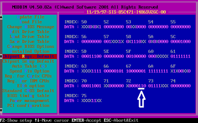

Reply 27 of 64, by TheMobRules
Here's the updated BIOS for the ASUS board using GigAHerZ's findings. It's the latest official version (0402.001) with a couple of bits swapped from 0 to 1 on register 72 to properly set L2 dirty tag:
0402.zip
43.78 KiB
119 downloads
ASUS VL/I-486SV2GX4 modded BIOS "0402.002"
14.6 KiB
2176 views
Register 72 swapped bits
Reply 29 of 64, by feipoa
That was one of the threads. Wasn't there one other thread as well? I know I modified the BIOS in MODBIN as well, but in another thread by PC-Engineer, I think.
Reply 30 of 64, by techweenie
