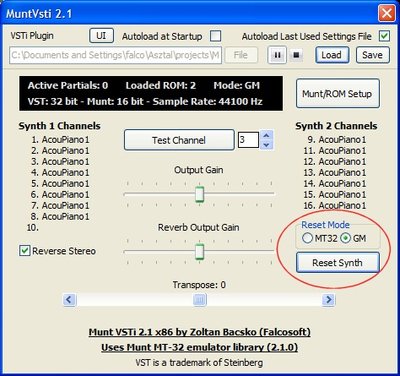

If you use SAVIHost anyway, you can test if it's really a GM/MT-32 problem more easily without changing DOSBOX config. Just load Munt VSTi into SAVIHost (or FSMP) and change the reset mode in MuntVSTi between GM and MT-32 mode. If the instruments sounds right in MT-32 mode then the problem is what MAN-biker has written, else try to use GM mode.
Edit:
If the game sends the appropriate reset message the situation is more simple. You will see on MuntVsti's interface if the game switched the synth into GM or MT-32 mode.

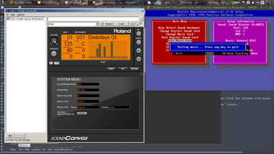

So I just managed to get this baby running under Linux. I ended up having to run Reaper. I pointed Dosbox at the Midi pass through port to send commands to the VST. I have been trying to get it working for months off and on via the demo and multiple Wine prefixes. You can get a trial version of Reaper here: http://www.reaper.fm
Me running it under WINE/Reaper:
299.74 KiB
5835 views
Desktop screen shot of it running under Linux via WINE/ reaper
EDIT: Going this route under Linux is a little on the pricey side at Approximately 185 USD, so about the same price as getting a real unit and MIDI controller, but infinity more portable for a laptop user like me.
If you want to save Reaper's $60 you can try FSMP under Wine. It works as a VST + Soundfont host and you can send it midi messages the same way through the Midi pass through port.
367.91 KiB
5831 views
Edit:
My problem under Wine is SC-VA itself. It only works in a never ending trial period (the problem is the 10 minutes/session restriction remained).
I have experienced the same when I tried SC-VA under XP. It works perfectly except the activation process/component.
